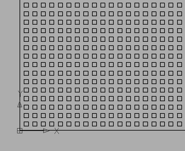

If using a hatch is to be considered, I thought to post a few hatches that might even be useful. My first effort was based on the pattern starting at 0,0, but see that the pattern should start at 0.002, 0.002 to give an edge. So I rewrote the definition and scaled it by 10 and 100 times as well as the proper scaling.
The first line of each definition is the file name that it should be saved as, and the picture is how it all starts at the bottom left hand corner.

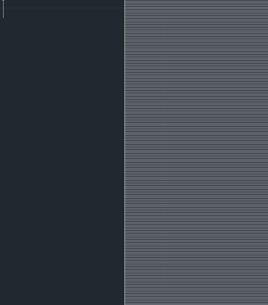

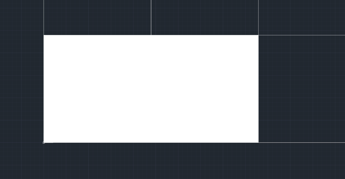

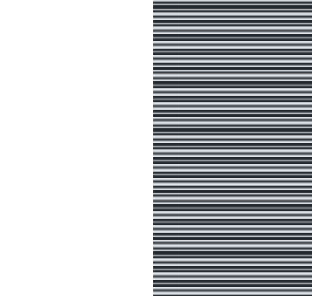

I am able to use the hatch pattern but Im starting to have trouble when it comes to scaling down the blocks. At first I tried to use the SBx1.pat you posted but for some reason autocad refused to do anything. I then moved onto using the SBx100.pat pattern and as I began scaling it down to .001 what shows up on my screen is a white pattern but as I zoom into it, it completely disappears and I cant see the pattern. I did create another custom hatch pattern that just consisted of straight lines and I was able to scale it down to .001 and lower and when I zoomed into I was able to make out the individual lines. I think that autocad is having an easier time making out the lines instead of the blocks. I posted some pictures below (block pattern on left, line pattern on right). if there is anyway to fix this I would gladly appreciate it
