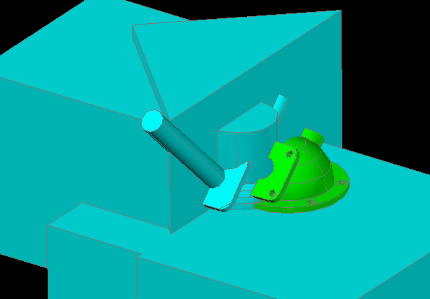

JD Mather Posted March 25, 2009 Posted March 25, 2009 Give me a command to research? solidhist brep Attached is the typical case I see. I moved the green desired part out and up a bit after repair. The cyan is the unexpected behavior. Quote
ILoveMadoka Posted March 25, 2009 Author Posted March 25, 2009 >>solidhist >>brep As stated above neither of those had any effect on the dwg... Quote
JD Mather Posted March 25, 2009 Posted March 25, 2009 Will not have effect on current work. Change for all future work if you don't want to see repeat behavior. Quote
