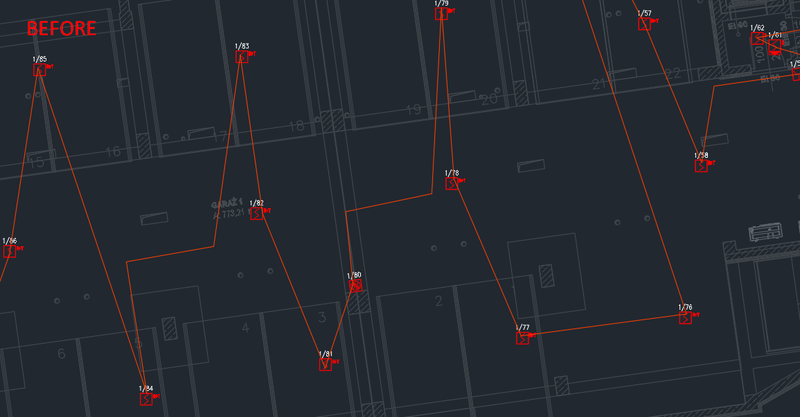

HypnoS Posted August 1, 2025 Author Posted August 1, 2025 TBH devito code meets my needs, for what i send big thanks once more. One thing I'd like to be added is to let me change distance between blocks Quote

HypnoS Posted August 1, 2025 Author Posted August 1, 2025 @SLW210 I tried yours but I cant get it to work, I think Im missing something. "Enter the tag to use" What tag am I supposed to type in? Attribute name or value does not work. Quote
devitg Posted August 1, 2025 Posted August 1, 2025 6 hours ago, HypnoS said: TBH devito code meets my needs, for what i send big thanks once more. One thing I'd like to be added is to let me change distance between blocks It ask you to set such distance Or you mean to set distance for each block at the straight line? Quote
SLW210 Posted August 1, 2025 Posted August 1, 2025 8 hours ago, HypnoS said: @SLW210 I tried yours but I cant get it to work, I think Im missing something. "Enter the tag to use" What tag am I supposed to type in? Attribute name or value does not work. The actual TAG name, in the drawing you posted it is ADRES Quote
HypnoS Posted August 4, 2025 Author Posted August 4, 2025 @devitgYeh! Distance between blocks on a new straight polly. @SLW210Sorry but typing block atribute or even clicling on it seems to no work for me Enter the tag to use: ADRES ; error: bad argument type: numberp: --- Quote
SLW210 Posted August 4, 2025 Posted August 4, 2025 I'll look into that, I might have posted the wrong one. I was working on one to just use the block clicked assuming a single attribute. Quote
devitg Posted August 4, 2025 Posted August 4, 2025 On 7/24/2025 at 1:26 PM, HypnoS said: Yours works great. the only thing I would like to add is to set a distance between blocks on the line, just like the copyblockstocurve has. @HypnoS Find attached cpy-blk-2-poly-01.lsp Quote
HypnoS Posted August 5, 2025 Author Posted August 5, 2025 @devitgcode acts weird. It asks me to type distance,and when I do it places only one block and asks for distance again to pace another block, and on and on. Quote

HypnoS Posted August 5, 2025 Author Posted August 5, 2025 well I hoped for this lisp to work with any blocks with attributes. here are the same b locks Im using. example [2].dwg Quote

devitg Posted August 5, 2025 Posted August 5, 2025 (edited) 5 hours ago, HypnoS said: @devitgcode acts weird. It asks me to type distance,and when I do it places only one block and asks for distance again to pace another block, and on and on. @HypnoS use the previous, reattached, It will ask for distance only once , and ask for the straight line start point to paste each block cpy-blk-2-poly.lsp copy block 2 poly 2025-08-05 10-37-41.rar Edited August 5, 2025 by devitg add info 1 Quote
devitg Posted August 6, 2025 Posted August 6, 2025 6 hours ago, HypnoS said: Thanks @devitg it works great! @HypnoS,, Glad to know. My version do not INSERT , just copy as you asked at the OP. Seem to be you need to make RISERS. Quote
