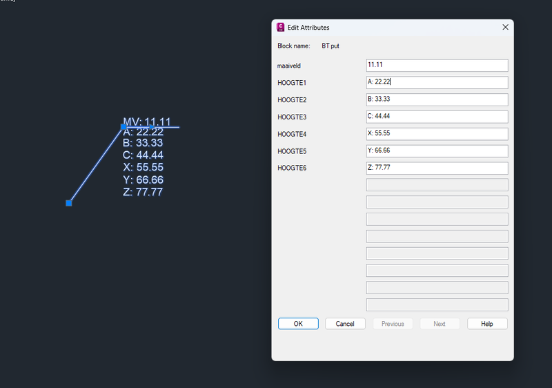

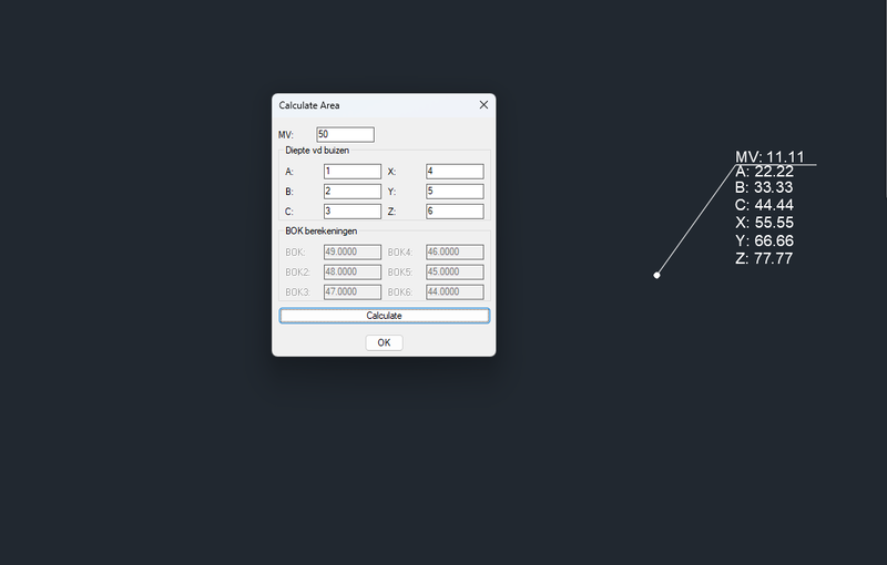

Kris Malen posted a topic in AutoLISP, Visual LISP & DCL
I want to change the values of a dynamic block within a lisp. This lisp contains a calculation. I used .dcl for this. My dynamic block has 7 attributes: maaiveld, HOOGTE1, HOOGTE2, HOOGTE3, HOOGTE4, HOOGTE5 and HOOGTE6. My lisp code has 7 values: m, a, b, c, x, y and z The order of these outputs are important. a, b, and c are sewer pipes that arrive in the cewer, and x, y, and z are pipes that depart from the sewer pit. So if there are only 2 pipes, we only have to use a and x. This makes it difficult. I can't just set HOOGTE1 to a, HOOGTE2 to b, HOOGTE3 to c, etc. If I do it this way, it will leave a gap in my leader. I hope this is even possible. I provided some screenshots of my calculator and of the leader, and the problem of the gap. Maybe I just need to create a more complex dynamic block, so that I can just connect the hoogte1,2,3,... to a,b,c,... I really don't know. code: (defun c:testKRIS ( / *error* dch dcl des mv d1 d2 d3 d4 d5 d6) (defun *error* ( msg ) (if (and (= 'int (type dch)) (< 0 dch)) (unload_dialog dch) ) (if (= 'file (type des)) (close des) ) (if (and (= 'str (type dcl)) (findfile dcl)) (vl-file-delete dcl) ) (if (and msg (not (wcmatch (strcase msg t) "*break,*cancel*,*exit*"))) (princ (strcat "\nError: " msg)) ) (princ) ) (cond ( (not (setq dcl (vl-filename-mktemp nil nil ".dcl") des (open dcl "w") ) ) (princ "\nUnable to open DCL for writing.") ) ( (progn (foreach str '( "ed : edit_box" "{" " alignment = left;" " width = 20;" " edit_width = 10;" " fixed_width = true;" "}" "" "test : dialog" "{" " spacer;" " key = \"dcl\";" " : ed" " {" " key = \"mv\";" " label = \"MV:\";" " }" " :boxed_column { " " label = \"Diepte vd buizen\";" " :row {" " : ed" " {" " key = \"d1\";" " label = \"A:\";" " }" " : ed" " {" " key = \"d4\";" " label = \"X:\";" " }}" " :row {" " : ed" " {" " key = \"d2\";" " label = \"B:\";" " }" " : ed" " {" " key = \"d5\";" " label = \"Y:\";" " }}" " :row {" " : ed" " {" " key = \"d3\";" " label = \"C:\";" " }" " : ed" " {" " key = \"d6\";" " label = \"Z:\";" " }}" " }" " : boxed_row" " { " " label = \"BOK berekeningen\";" " :column {" " : ed { key = \"res\"; label = \"BOK:\"; is_enabled = false; }" " : ed { key = \"res2\"; label = \"BOK2:\"; is_enabled = false; }" " : ed { key = \"res3\"; label = \"BOK3:\"; is_enabled = false; }" " }" " :column{" " : ed { key = \"res4\"; label = \"BOK4:\"; is_enabled = false; }" " : ed { key = \"res5\"; label = \"BOK5:\"; is_enabled = false; }" " : ed { key = \"res6\"; label = \"BOK6:\"; is_enabled = false; }" " }" " }" " : button" " {" " key = \"cal\";" " label = \"Calculate\";" " }" " spacer;" " ok_only;" "}" ) (write-line str des) ) (setq des (close des) dch (load_dialog dcl) ) (<= dch 0) ) (princ "\nUnable to load DCL file.") ) ( (not (new_dialog "test" dch)) (princ "\nUnable to display 'test' dialog.") ) ( t (set_tile "dcl" "Calculate Area") (action_tile "mv" "(setq mv $value)") (action_tile "d1" "(setq d1 $value)") (action_tile "d2" "(setq d2 $value)") (action_tile "d3" "(setq d3 $value)") (action_tile "d4" "(setq d4 $value)") (action_tile "d5" "(setq d5 $value)") (action_tile "d6" "(setq d6 $value)") (action_tile "cal" (vl-prin1-to-string '( (lambda ( / m x y z a b c ) (set_tile "res" "") (set_tile "res2" "") (set_tile "res3" "") (set_tile "res4" "") (set_tile "res5" "") (set_tile "res6" "") (cond ( (or (not mv) (= "" mv)) (alert "Please enter a maaiveld value.") (mode_tile "mv" 2) ) ( (or (not d1) (= "" d1)) (alert "Please enter a A value.") (mode_tile "d1" 2) ) ( (or (not d2) (= "" d2)) (alert "Please enter a B value.") (mode_tile "d2" 2) ) ( (or (not d3) (= "" d3)) (alert "Please enter a C value.") (mode_tile "d3" 2) ) ( (or (not d4) (= "" d4)) (alert "Please enter a X value.") (mode_tile "d4" 2) ) ( (or (not d5) (= "" d5)) (alert "Please enter a Y value.") (mode_tile "d5" 2) ) ( (or (not d6) (= "" d6)) (alert "Please enter a Z value.") (mode_tile "d6" 2) ) ( (not (setq m (distof mv))) (alert "Het Maaiveld moet een getal zijn.") (mode_tile "mv" 2) ) ( (not (setq a (distof d1))) (alert "The A must be numerical.") (mode_tile "d1" 2) ) ( (not (setq b (distof d2))) (alert "The B must be numerical.") (mode_tile "d2" 2) ) ( (not (setq c (distof d3))) (alert "Het C moet een getal zijn.") (mode_tile "d3" 2) ) ( (not (setq x (distof d4))) (alert "The X must be numerical.") (mode_tile "d4" 2) ) ( (not (setq y (distof d5))) (alert "The Y must be numerical.") (mode_tile "d5" 2) ) ( (not (setq z (distof d6))) (alert "The Z must be numerical.") (mode_tile "d6" 2) ) ( (<= m 0.0) (alert "Het maaiveld moet groter dan nul zijn.") (mode_tile "mv" 2) ) ( (<= a 0.0) (alert "The A must be greater than zero.") (mode_tile "d1" 2) ) ( (<= b 0.0) (alert "The B must be greater than zero.") (mode_tile "d2" 2) ) ( (<= c 0.0) (alert "Het C moet groter dan nul zijn.") (mode_tile "d3" 2) ) ( (<= x 0.0) (alert "The X must be greater than zero.") (mode_tile "d4" 2) ) ( (<= y 0.0) (alert "The Y must be greater than zero.") (mode_tile "d5" 2) ) ( (<= z 0.0) (alert "The Z must be greater than zero.") (mode_tile "d6" 2) ) (t (set_tile "res" (rtos (- m a) 2)) (set_tile "res2" (rtos (- m b) 2)) (set_tile "res3" (rtos (- m c) 2)) (set_tile "res4" (rtos (- m x) 2)) (set_tile "res5" (rtos (- m y) 2)) (set_tile "res6" (rtos (- m z) 2)) ) ) ) ) ) ) (start_dialog) ) ) (*error* nil) (princ) ) The code needs work to be visually better, but I want it to work before I do that.- 6 replies
