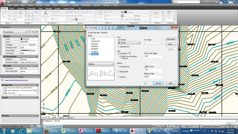

  7. I have a topography drawing with lots of numbers in it. Plotting in A3 paper, doesn't show the numbers. I tried to change the height of numbers globally through the style command. The present height is 0.3. I change it to 6 but nothing happens in the monitor. However when I change the oblique angle, I can see the effect on the monitor. BTW the style name is "standard" and fonta name is: txt.shx Am I doing something wrong? How can I change the height for whole numbers in one step?
