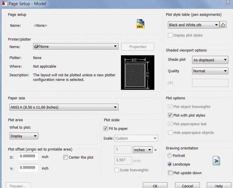

monochrome.ctb if you are talking about the printed color. If it is the color of the line on the screen then go to the layer manager and set all your layers to the color you want or in the drawing select, all and then change the color to the desired one in your object properties.
