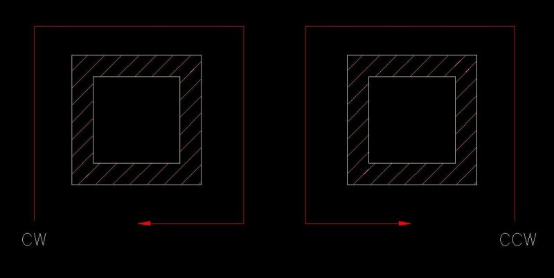

The Buzzard Posted October 2, 2010 Share Posted October 2, 2010 (edited) Well, I did modify it to go in either direction, However you need a prompt to indicate it. The prompt in this program asks for CW or CCW. (See Image for Clarification) I kept the prompt to come on after the loop and was not sure how you would feel about that, But I can move it if you like it to come on at the program start only. Its up to you. Just remember to select the points along the outside of the encasement. CW or Clockwise is set as the default. I assume you are using this for column encasements, So I made the image accordingly. Let me know what you think. ANSI.lsp Edited October 2, 2010 by The Buzzard Quote Link to comment Share on other sites More sharing options...

jake77777 Posted October 2, 2010 Author Share Posted October 2, 2010 Sorry, I guess what I meant is with the previous lisp if you start the hatch from right to left and the the hatch would import upwards..anyway to make it go downward? Quote Link to comment Share on other sites More sharing options...
The Buzzard Posted October 2, 2010 Share Posted October 2, 2010 Sorry, I guess what I meant is with the previous lisp if you start the hatch from right to left and the the hatch would import upwards..anyway to make it go downward? Did you test the program yet? Just answer the prompt. Specify hatch direction. [CW/CCW] : Quote Link to comment Share on other sites More sharing options...
The Buzzard Posted October 2, 2010 Share Posted October 2, 2010 Did you test the program on post no.23? Quote Link to comment Share on other sites More sharing options...
jake77777 Posted October 2, 2010 Author Share Posted October 2, 2010 It's sad, I'm so use to having two option icons in my toolbars. Such as two mirror icons..one with which would delete source object and one that wouldn't just so I don't have to be prompted..For the use with the walls..I won't be going back and forth as I encounter an area that needs to be hatched rather I do all the walls at once..So...That last lisp is perfect! And one less icon..forgive my ignorance, Still a newb! Thanks Buzzard! Quote Link to comment Share on other sites More sharing options...
The Buzzard Posted October 2, 2010 Share Posted October 2, 2010 So the program on post 23 is OK or are you referring to the program that was posted yesterday? Quote Link to comment Share on other sites More sharing options...
jake77777 Posted October 2, 2010 Author Share Posted October 2, 2010 Post 23 is the one! Love it Buzzard! Quote Link to comment Share on other sites More sharing options...
