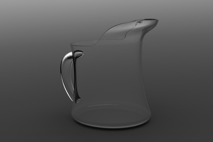

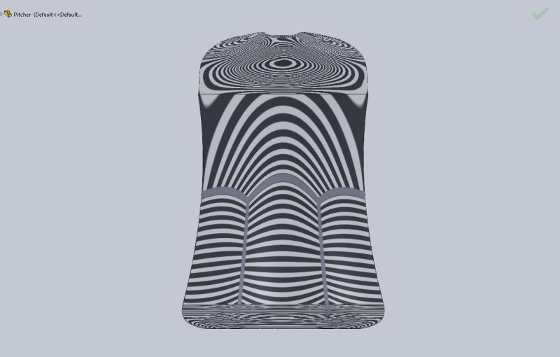

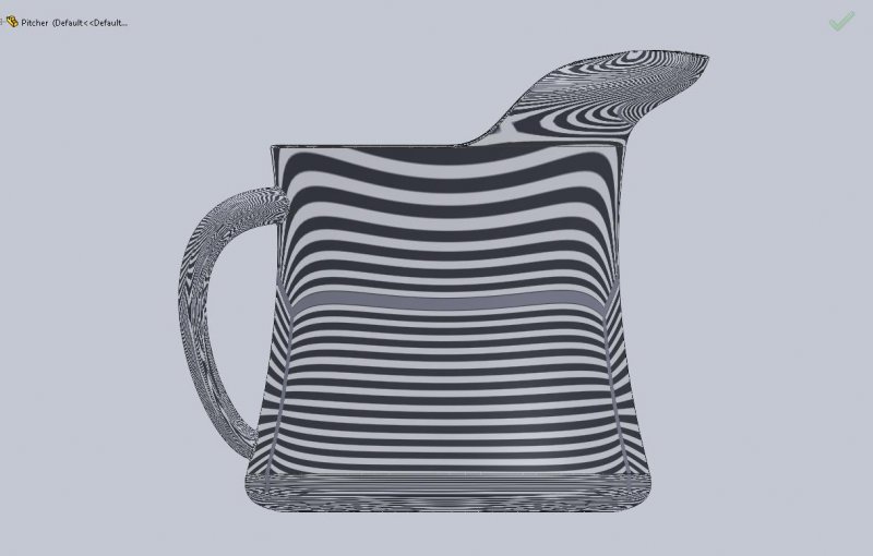

shift1313 Posted November 2, 2010 Share Posted November 2, 2010 Here is a surfacing tutorial I wrote for solidworks. You guys could try and follow it with inventor. http://ola2.aacc.edu/tmcallinan/ENT280/Complex%20Surfacing-Speaker.pdf One thing I thought was a fun and relatively quick exercise is creating a water pitcher. Here are a few screen shots of one i drew and a render. Quote Link to comment Share on other sites More sharing options...

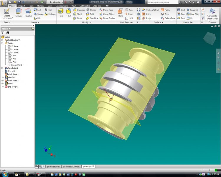

rdharvey Posted November 18, 2010 Share Posted November 18, 2010 Here we go guys. i blasted through it in a couple of hours this afternoon.... what you think? hope you have time to have a go. Quote Link to comment Share on other sites More sharing options...
Calibos Posted November 18, 2010 Share Posted November 18, 2010 Just got it today harvey...for some reason msn messenger decided to put it in my deleted box:?.....your image looks superb..is it a inventor render or some other software?... gonna have a lot to live up to Quote Link to comment Share on other sites More sharing options...
gbradley Posted November 18, 2010 Share Posted November 18, 2010 Looks good, but are the ports too small? Quote Link to comment Share on other sites More sharing options...
Calibos Posted November 18, 2010 Share Posted November 18, 2010 is this hole threaded on the piston? Quote Link to comment Share on other sites More sharing options...
Steve_wright Posted November 18, 2010 Author Share Posted November 18, 2010 Yes got mine too.....this looks an excellent project!! i reckon i will learn quite allot of this .. I've sent you an email regarding the nut.. Cheers Steve:thumbsup: Quote Link to comment Share on other sites More sharing options...
rdharvey Posted November 19, 2010 Share Posted November 19, 2010 Just got it today harvey...for some reason msn messenger decided to put it in my deleted box:?.....your image looks superb..is it a inventor render or some other software?... Hmmm hotmail is a strange thing!! Thanks dude it was all done in inventor and inventor studio... Simple render really i just used all the basic settings that are already set up withing the inventor studio environment. Wish i still had hypershot and SW photo-view 360. They where awesome! As for the hole on the piston i believe that is right yes. Quote Link to comment Share on other sites More sharing options...
rdharvey Posted November 19, 2010 Share Posted November 19, 2010 Looks good, but are the ports too small? Don't think so, i just followed the drawings.... it all seemed fine though. Quote Link to comment Share on other sites More sharing options...

Hopinc Posted November 19, 2010 Share Posted November 19, 2010 (edited) Hi Rob, PhotoView 360, which incidentally is now incorporated into SW2011, is not really any better than Inventor Studio in my opinion. Hyperhsot, or better yet KeyShot, has a totally different way of working, and one I personally find somewhat frustrating. For instance, having to create emmisive planes for extra lighting really is not my idea of how it should be done, although it does have some interesting uses. I noticed from your rendering that you have not got perspective switched on -this immediately gives a "queer" look to your image as it gets wider in the distance. Please don't take this the wrong way, but in the spirit that it is intended, but I think your lighting needs work, so do your shadows and reflections, as they have too much impact on the image (this is my personal opinion). Inventor Studio is actually quite a flexible program, but you need to put a lot of effort and experimentation in to really master it. I guess I have accumulated a lot of experience with Studio and I feel that most people do not experiment anywhere near enough and just accept the default settings. It has a lot more to offer with practice. It is not an easy subject to explain as I personally do a lot of tweaking to my images, and this can take hours, but if you think I can be of any help please ask. Regards, Dave Edited November 19, 2010 by Hopinc Quote Link to comment Share on other sites More sharing options...
