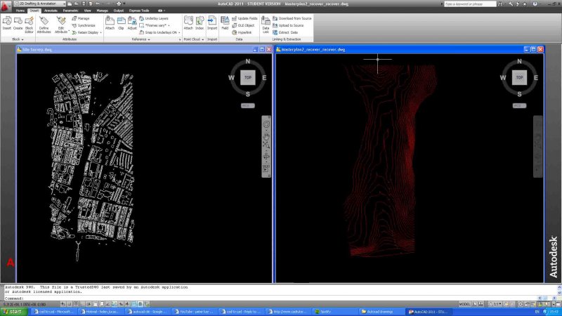

helen Posted May 19, 2011 Share Posted May 19, 2011 Hello out there, CAn anyone help? I am trying to put a layer from a cad drawing into another cad drawing. When I 'insert' it, it comes out all blobby and wierd. Surely this should be quite simple? Helen Quote Link to comment Share on other sites More sharing options...
cadvision Posted May 19, 2011 Share Posted May 19, 2011 helen From what program to what program. How are you copying your data? Are you just using Windows copy/paste? If so your data may be coming in as an OLE object. Best to save the date from first program, I'll assume AutoCAD as a DXF file or older DWG and then import it into your other program. Quote Link to comment Share on other sites More sharing options...
helen Posted May 20, 2011 Author Share Posted May 20, 2011 'from a cad drawing into another cad drawing' I did try to do copy/paste but no result which is why I tried to insert the drawing layer but it came in wierd and unusable. What is OLE? Thanks for your help... Quote Link to comment Share on other sites More sharing options...

helen Posted May 20, 2011 Author Share Posted May 20, 2011 I have attached a picture of what I am trying to do, I hope it works. I would like to know how to put the red poly line contours layer on the right cad drawing, in to the white line cad drawing on the left. Is the insert tool a way of doing it? if so, how? because I have know idea how it works or what its for. I tried to copy paste the same way as in windows word, but it didnt work, can some one explain how to copy paste in cad? what is the difference between dwg and dxf? What is OLE? What is design center? Many thanx for your helps Quote Link to comment Share on other sites More sharing options...
helen Posted May 20, 2011 Author Share Posted May 20, 2011 here is attachment Quote Link to comment Share on other sites More sharing options...
scottish-lawd Posted May 20, 2011 Share Posted May 20, 2011 Helen it may be a scale issue as one is scale of 1to1 and other is 1000to1 check this out when pasting Quote Link to comment Share on other sites More sharing options...
ReMark Posted May 20, 2011 Share Posted May 20, 2011 To use Copy/Paste both drawings need to be open. The best option with Copy/Paste is to do it with a know base point that is present in both drawings. That ensures that the contours will overlay the site plan accurately. You must also know if the drawings are done to the same scale or not since you may be required to scale the contours up or down upon insertion. Do you have or know any of this information? Why are you asking about DXF? I see no need for its use in this case since you have two separate DWG files or are we still missing a vital piece of information? Why the question about OLE? Are you being asked if you want to insert the contours as an OLE object? Design Center is an AutoCAD feature which allows you to bring content, like blocks, layers, layouts, linetypes, etc., from one AutoCAD drawing into another drawing without using the Copy/Paste command. Quote Link to comment Share on other sites More sharing options...

helen Posted May 20, 2011 Author Share Posted May 20, 2011 Thanks Re Mark, I do know what you are saying.....I just realised that to copy paste you have to have the lines selected with the blue squares! So now it is in the drawing I want it in. But now I cant change the pasted lineweights in properties to 0.25 why wont it let me change the line weight? I was asking about DXF and OLE because it was mentioned by another member in a previous post. I am studying landscape architecture, its expected to know cad but they dont teach you What are clipped xrefs? Best, H Quote Link to comment Share on other sites More sharing options...
ReMark Posted May 20, 2011 Share Posted May 20, 2011 You are expected to know CAD but they don't teach you? What college is this? Helen: You keep changing topics on us. Now you are inquiring about Xrefs. Did you read about them in another post too? Let's go back to the contours that you brought into your drawing using Copy/Paste. Did you paste them as a block? How are you trying to change the lineweight of the contours? Is it in the drawing itself (by giving them a width) or in the Layer Properties Manager under the heading "Lineweight"? An Xref is an external reference. One drawing can reference another drawing by attaching it as an xref. When changes are made to the drawing that is being referenced you will see those changes reflected in your drawing when you open it the next time. That means AutoCAD is always referencing the latest version of the drawing. Quote Link to comment Share on other sites More sharing options...
Dana W Posted May 20, 2011 Share Posted May 20, 2011 If your lines were not inserted or pasted as a block, you may be changing the lineweights but the program might not be set to display any differential in lineweights. Type LWEIGHT into the command line and hit enter. Adjust the settings to your liking. You can toggle lineweight display on and off with the button at the bottom of the screen that looks like a smudged + sign. With it off, all of them are displayed at the same default weight. Quote Link to comment Share on other sites More sharing options...
