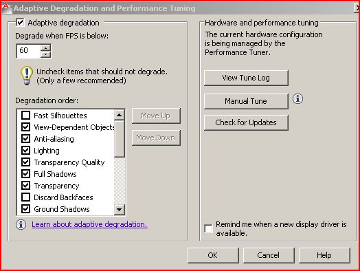

Dadgad Posted May 19, 2012 Share Posted May 19, 2012 (edited) Yep...I know all this....I think I will just put AutoCAD 2007 back on here...... I cant yet make since of paying another $4000.00 for ANOTHER estimating program which I would have to do if I switched to 64 bit.. I just cant do it Thank You SO much guys!!! Working in 3DHIDDEN visual style is so much slower than 2D WIREFRAME or CONCEPTUAL, have you considered working in either of those? Do you have ADAPTIVE DEGRADATION turned on, and tuned to your specific tastes? The default setting of 5fps can be boosted to 60fps, which is a significant increment. I personally find 2012 to be very stable and a nice upgrade from 2010. Have you used the VIEWBASE functions which were introduced in 2012? They could be really useful generating 3D isometric view dwgs for your customers. Edited May 19, 2012 by Dadgad Quote Link to comment Share on other sites More sharing options...
