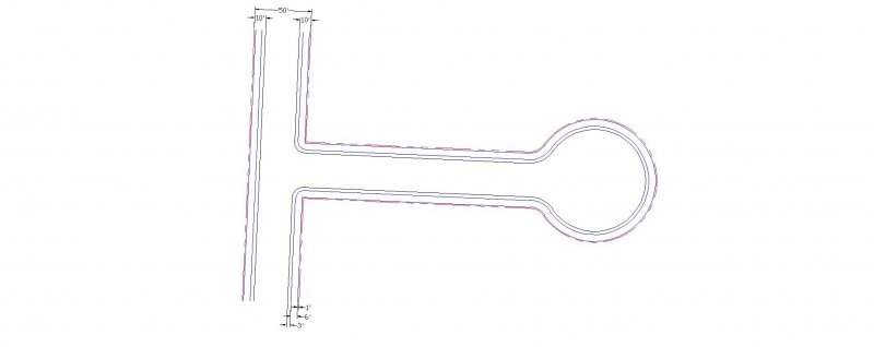

cosme017 Posted July 8, 2012 Author Share Posted July 8, 2012 (edited) ok, so looking at a previous post from sdick, I am wondering by looking at the diagram from the professor it seems as though the curb is offset 2ft to the road side, and so is there suppose to be a layer for the "planting" strip/buffer? how do I show these measurements? Edited July 8, 2012 by cosme017 Quote Link to comment Share on other sites More sharing options...

ReMark Posted July 8, 2012 Share Posted July 8, 2012 (edited) The offsets given are 6.00, 1.00 and 3.00 for a total of 10.00. I have a strong disagreement with how the instructors have gone about interpreting these offsets. Anyone who has worked for a municipality would generally accept the fact that the curb and sidewalk fall within the streetlines and not outside them. When I researched this I actually found the regulations for the city in Pennsylvania that Penn_Foster is located in and confirmed it yet they have the students doing something quite different. I covered this, in depth, in another thread. I don't believe the instructions actually call for dimensions per se. Re: Trees. A correction. The two layers for the trees are Trees Save (color: green) and Trees Remove (Color: blue). Edited October 20, 2013 by ReMark Quote Link to comment Share on other sites More sharing options...

ReMark Posted July 8, 2012 Share Posted July 8, 2012 This is how I believe the drawing should be done with regards to the offsets for the buffer, sidewalk and parking strip. The 1.00 buffer is the distance between the back of the sidewalk and the streetline/front property line. The sidewalk is 6.00. Then there is the 3.00 offset for the parking strip. This last line, in my opinion, represents the face of curb. Since most curbs are 6" in width but the scale of the map is so large (1'=50') there is no sense showing the true width as the two lines would plot too close together. Quote Link to comment Share on other sites More sharing options...

cosme017 Posted July 8, 2012 Author Share Posted July 8, 2012 [ATTACH=CONFIG]35818[/ATTACH] This is how I believe the drawing should be done with regards to the offsets for the buffer, sidewalk and parking strip. The 1.00 buffer is the distance between the back of the sidewalk and the streetline/front property line. The sidewalk is 6.00. Then there is the 3.00 offset for the parking strip. This last line, in my opinion, represents the face of curb. Since most curbs are 6" in width but the scale of the map is so large (1'=50') there is no sense showing the true width as the two lines would plot too close together. So, I guess this diagram shows that the instructor has no clue about the project. Which I can believe. Thank you Quote Link to comment Share on other sites More sharing options...
ReMark Posted July 8, 2012 Share Posted July 8, 2012 I believe the instructor's sketch to be in error. However, since this is what he expects to see then you would be wise to reproduce it in your CAD drawing. Consider this...the parking strip is supposed to be 3.00 and the buffer 1.00 yet in the instructor's sketch he has combined the buffer with the parking strip. In the municipality where I worked for eight years (engineering department) one of my duties was to draw street line maps for all of our roads. Our "typical" street had a R.O.W. (right-of-way) of 50 feet (streetline to streetline). 10 feet on each side (for a total of 20 feet) was given over to the buffer, side walk, grassy strip and curb leaving a paved road width of 30 feet. Quote Link to comment Share on other sites More sharing options...

ReMark Posted July 9, 2012 Share Posted July 9, 2012 FYI - I sent off an email to Penn-Foster this morning telling them they should correct the misinformation contained with the Oleson Village instructional PDF as it regards the location of the buffer, sidewalk, planting ( not "parking) strip and the curb. I think they should at least provide the student with the proper information along with a sketch so there is no confusion in the future. BTW, I checked the local regulations of the city P-F is located in and they don't even follow them. Makes me wonder what genius wrote the project instructions. Quote Link to comment Share on other sites More sharing options...
