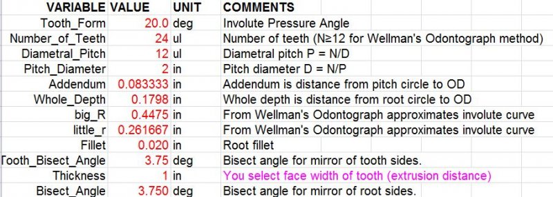

spinecad Posted January 1, 2013 Author Share Posted January 1, 2013 You entirely missed my point. Am I? Which one? Please explain. We already did 12 teeth. Yes, and now I would like to know how to drawing its mating gear. Say the gear ratio be 1:2. Quote Link to comment Share on other sites More sharing options...
JD Mather Posted January 1, 2013 Share Posted January 1, 2013 Here are parameters for 24 tooth gear. I'll let you give it a shot first. (BTW the Thickness is if you were going to extrude into 3D solid part.) Quote Link to comment Share on other sites More sharing options...
spinecad Posted January 1, 2013 Author Share Posted January 1, 2013 Here are parameters for 24 tooth gear.I'll let you give it a shot first. (BTW the Thickness is if you were going to extrude into 3D solid part.) [ATTACH=CONFIG]39434[/ATTACH] Okay. Okay. Quote Link to comment Share on other sites More sharing options...

JD Mather Posted January 5, 2013 Share Posted January 5, 2013 Hi JD Mather, I am waiting the next step. I assume this is a language barrier. I'll let you give it a shot first. I meant give it a try on your own this time and post the results here or indicate when you have trouble. In any case - you should understand by now that the first step was posted in response #6. I recommend that you sign up for a class. Quote Link to comment Share on other sites More sharing options...
