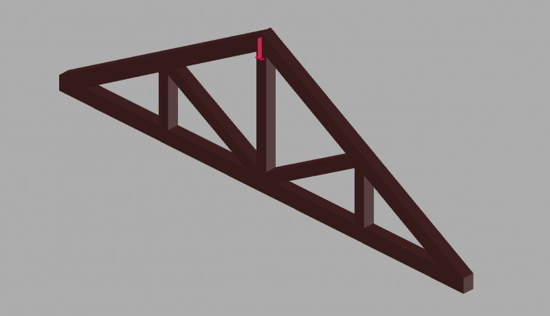

ReMark Posted February 6, 2013 Share Posted February 6, 2013 Main Truss (12" thick) as per your drawing. Objects are 3D solids. Visual style is Realistic. No materials applied. Quote Link to comment Share on other sites More sharing options...

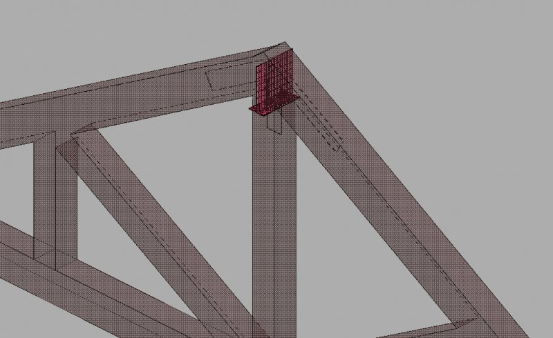

ReMark Posted February 6, 2013 Share Posted February 6, 2013 Detail at top of truss. Visual style is X-Ray. Can you tell us what it is you are doing here? I'd be interested in learning. Thanks. Quote Link to comment Share on other sites More sharing options...
D Mills Posted February 6, 2013 Author Share Posted February 6, 2013 Truss dims are correct that is the Aspen Valley Harley Davidson dealership that my company did in Colorado along with all exterior and interior trim. Current pic log at dmillsstudioanddesign.com . Thanks again for all of the help it will be good to finally get rid of my vices. Quote Link to comment Share on other sites More sharing options...
ReMark Posted February 6, 2013 Share Posted February 6, 2013 Can you educate me on what you did or is it a trade secret? I like learning new things too. Thanks. Quote Link to comment Share on other sites More sharing options...
D Mills Posted February 6, 2013 Author Share Posted February 6, 2013 That was to show that you could not install the steel in the peak without disturbing the structural integrity of the timber frame components being used ( in a nut shell we would have to butcher them/cut them apart to insert the steel plate they had designed. Quote Link to comment Share on other sites More sharing options...
ReMark Posted February 6, 2013 Share Posted February 6, 2013 Ah, I see. OK. Well thanks for the explanation. I was having a difficult time trying to understand the concept. So, what about the Chevy bar? Any further progress? Quote Link to comment Share on other sites More sharing options...
