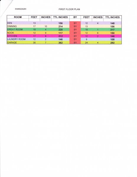

welldriller Posted March 13, 2013 Share Posted March 13, 2013 kharizzajeh: If you are still around and have not figured out your walls here are a few suggestions SAMPLE WALLS.dwg Quote Link to comment Share on other sites More sharing options...
welldriller Posted March 13, 2013 Share Posted March 13, 2013 KHARIZZAJEH: If you are trying to make a drawing of of the plan you posted Don not think you have enough information But maybe this will help Quote Link to comment Share on other sites More sharing options...
