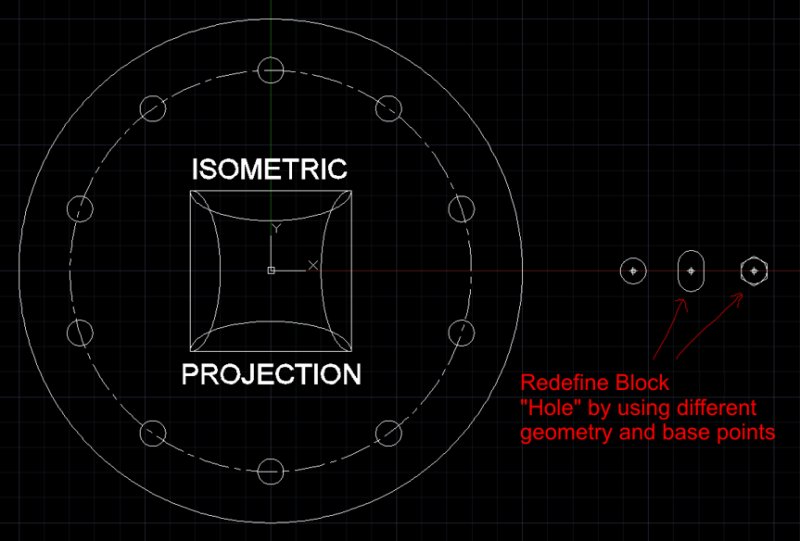

SEANT Posted September 15, 2013 Share Posted September 15, 2013 I agree with all the recommendations to use 3D if you can. It is the best way of deriving Isometric, or any of the other projections for that matter. If 3d and/or lisp were not an option – using AutoCAD LT, for instance – Maxelkat demos a good method in this thread: http://www.cadtutor.net/forum/showthread.php?35359-Isometric-drawing-made-easy!! The method can be pre-set, but allow for modification that will automatically update an Iso layout. See the image and file below. IsoViaBlock.dwg Quote Link to comment Share on other sites More sharing options...
