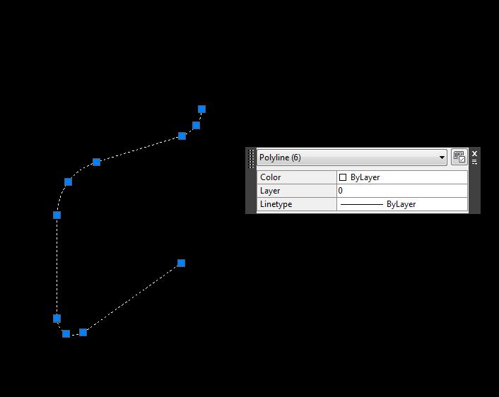

Laurel Posted January 6, 2015 Share Posted January 6, 2015 Hi I often receive drawings that I am required to modify, where I need to join various geometry into a polyline. I generally use the pedit command, select multiple lines, convert them to polylines if necessary and attempt to join them. I am coming across a good deal of examples where, regardless of the FUZZ option I use, I cannot seem to join them into a single polyline. Please find attached an example that I have been unable to join. Can anybody explain why I have this problem and the easiest way to resolve it? Thanks POLYLINE.dwg Quote Link to comment Share on other sites More sharing options...
ReMark Posted January 6, 2015 Share Posted January 6, 2015 I was able to do it but first I had to run the OVERKILL command to rid your drawing of the six overlapping lines. Attention to detail is critical. PeditProblemSolved.dwg Drawing saved in 2010 file format. Quote Link to comment Share on other sites More sharing options...
Laurel Posted January 6, 2015 Author Share Posted January 6, 2015 Thanks for your reply. I completely agree that attention to detail is critical. Unfortunately I have no say in the (sub)standard of the drawings I receive to edit. Unfortunately, I don't have the OVERKILL command installed, and I am unable to do so any time soon, if at all. I have since read up on OVERKILL, and as I understand it, it will remove any duplicate lines. You also mention that you used it to remove 6 such lines from my example. Please can you explain where these lines are? As you can see from the attached screenshot, I can only detect the 6 polylines that I am trying to join. Do you have any suggestion about how to resolve this WITHOUT overkill on AutoCAD 2010? Thanks. Quote Link to comment Share on other sites More sharing options...
ReMark Posted January 6, 2015 Share Posted January 6, 2015 First. If you have AutoCAD 2010 you have access to the OVERKILL command if you bothered to install Express Tools. Second. OVERKILL did not remove six duplicate lines it did however find and fix six over-lapping lines. Quote Link to comment Share on other sites More sharing options...
nestly Posted January 6, 2015 Share Posted January 6, 2015 If you look at the PLines in the Properties Palette, they're all already "Closed", and you can't join to a Polyline that's already closed. As Remark indicated, this is because it's basically a double object that's folded back on itself. OVERKILL should work, FLATTEN should work (remove hidden lines), and EXPLODE should work also (after you erase 6 of the 12 resultant objects) Quote Link to comment Share on other sites More sharing options...

nestly Posted January 6, 2015 Share Posted January 6, 2015 With regard to the first issue, unfortunately, I don't have good suggestion that doesn't involve an Express Tool (BTW, Express Tools are just lisps that were created by users that Autodesk collected and offered as a bonus,) It would probably not be difficult to find/install them "IF" you can gain permission to do so. With regard to the 2nd issue, there are small gaps between the ends of the polylines (may have to increase the precision in UNITS to measure them) Perhaps try the BOUNDARY command (BPOLY) which will create a new closed polyline from the loop/enclosed area on the current layer, so that should help with having to go back and delete the original geometry. Quote Link to comment Share on other sites More sharing options...

Laurel Posted January 6, 2015 Author Share Posted January 6, 2015 ReMark: Thanks for the suggestion. The PC's (and software) in my company are maintained by an external company. They are difficult to get hold of at the best of times. I've searched for the file (acetutil.arx) but it appears to be missing from my hard drive, although I don't have the required PC permissions to install it if it was there, so your link on how to install it won't help. Very much appreciate the suggestion tho. Nestly: Thanks very much. The Boundary (bpoly) command is exactly what I need! My company receives many files that have (apparently) been created on 3rd party software. A major part of the work my dept. does is to make changes which involve producing a continuous pline (for CNC purposes). Up until now, my colleagues have been picking each endpoint and snapping it manually to the adjacent point. The bpoly command allows us to skip all this, and do the task with one command. You've helped no end. Thank you!! Quote Link to comment Share on other sites More sharing options...
