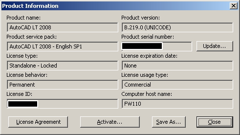

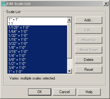

slimpickinz Posted March 25, 2015 Author Share Posted March 25, 2015 SLW... Actually heard that about SP1, but it is recently installed and did not make much of a difference... Will try the utility and post back results. Will work on a method of scripting this server-side after a few test runs locally. Dana W-- I haven't seen any xref scales in the list at all, but a bunch of others... By deleting as many of these as possible, the file size is reduced somewhat. By killing the unreferenced scales & running a quick script, I can cut this baby down from 2MB to 1100KB. Very good reduction. I have an option I have been using... remoting into an unattended machine with 2012 LT installed and opening the file and clicking YES... A bit of a burden but it sure helps the efficiency moving forward. Anyone.... How could I add _scalelistedit (& select the scales not in use and delete) to the following script? _model -purge r * n -purge a * n audit y zoom extents qsave Quote Link to comment Share on other sites More sharing options...

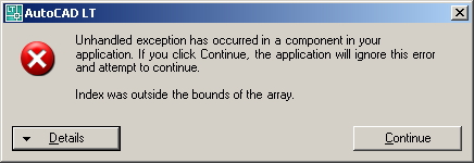

slimpickinz Posted March 25, 2015 Author Share Posted March 25, 2015 Now, everytime I go to Format... Scales list... I get that exception error dialog. I believe I will approach the powers to be and see about that upgrade! -SlimP Quote Link to comment Share on other sites More sharing options...
Dana W Posted March 25, 2015 Share Posted March 25, 2015 2 meg down to to 1.1 meg? I was talking 15 to 20 meg down to 500kb after unbloating. But, yeah the best move is off of 2008 altogether. You know there are 40 or so scales that come canned in AutoCad but most people only use 4 or 5. Maybe you have deleted some of the standard ones and the data file has less items than the program code is trying to process. Try the reset scale list button to get the OEM list back. Quote Link to comment Share on other sites More sharing options...
Dana W Posted March 25, 2015 Share Posted March 25, 2015 Dana W-- I haven't seen any xref scales in the list at all, but a bunch of others... [ATTACH=CONFIG]53444[/ATTACH] I see service pack 0. It doesn't just concatenate the xref stuff, it seems to rename and add back in its own scale list too. Quote Link to comment Share on other sites More sharing options...
Dana W Posted March 26, 2015 Share Posted March 26, 2015 Sounds like you do not have all the service packs, I believe this was fixed in service pack 1. AutoCAD LT 2008 Service Pack 1 AutoCAD 2008 Service Pack 1 (if someone using full 2008 comes across this thread) There is a scale list clean up utility to clean files created prior to the service pack install. Scale List Cleanup Utility for AutoCAD 2008/2009 http://autodesk.blogs.com/between_the_lines/2008/04/scale-list-clea.html The 2008 LT I was using last year at work, also had service pack 1, and the scale list bloat hotfix too. It still did it. Quote Link to comment Share on other sites More sharing options...
slimpickinz Posted March 26, 2015 Author Share Posted March 26, 2015 oops! Posted the wrong image... And the file size reduction is nearly 50% of the original... regardless of what the size, it will eventually make a difference. It also effects the performance. Pushing for that upgrade today! Thanks for all the input guys. -SlimP Quote Link to comment Share on other sites More sharing options...

rkmcswain Posted October 11, 2019 Share Posted October 11, 2019 On 3/25/2015 at 1:21 PM, slimpickinz said: Now, everytime I go to Format... Scales list... I get that exception error dialog. I believe I will approach the powers to be and see about that upgrade! -SlimP That particular problem is because there are more scales in the drawing, than the dialog is equipped to contain. In this case, use the command line version [-scalelistedit] Quote Link to comment Share on other sites More sharing options...
