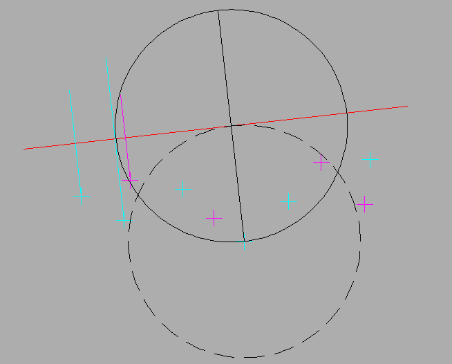

Hi, in a drawing I have already drawn a line (red line) that I must use to trace other perpendicular lines.
The perpendicular lines that I have to trace must use the red line already drawn as median.
For perpendicular lines, I know the starting points, so "half" of the total length I need.
Is it possible to draw perpendicular lines in a single operation?...without using subsequentlythe mirror command or scale command...

eldon
I can think of a way but it involves some temporary drawing which would have to be erased. I am not sure of your aversion to excess drawing!
You can draw a circle, centred on a point, with radius perpendicular to the median line. Then move this circle from the point to the intersection of the circle with the median line. Then draw your line from the point to the perpendicular to the opposite side of the circle. Erase the circle.

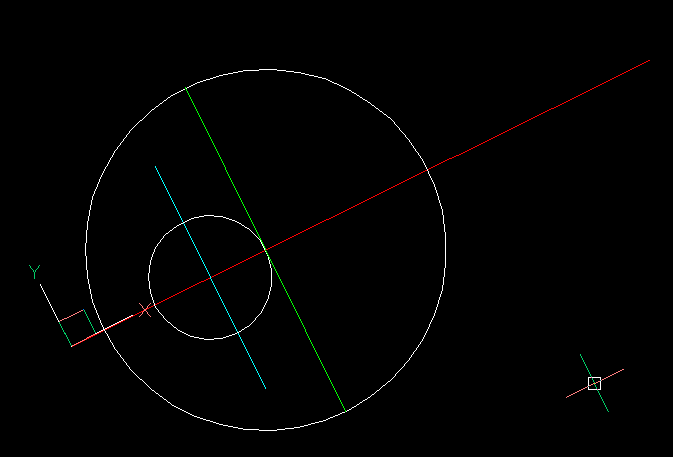

BIGAL
UCS OB red line
circle for offset cen pt from existing say blue.red point
circle rad = length for each side
line quad quad
erase circles
UCS w
