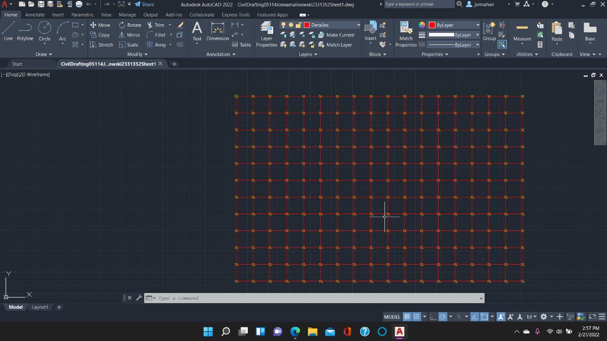

I'm working on a project for Penn Foster the Structural Civil Drafting Project. I've created the grid with the surveyor's spot elevation and grid. I have the spread sheet ready to go. I'm at a point where I need to interpolate contour lines. I don't know what they are asking at all. I understand what interpolation is and the mathematical equation that is needed. We have not done this before. This is what it says. Now, you need to figure out where the contour intervals cross the grid lines between each spot elevation. Create contours at 10′ intervals for just the 100′–180′ contour lines. You can estimate where a contour line intersects a grid line using interpolation.
1.) How do I know where the intervals cross the lines? Are they asking us to interpolate what the level is in the exact middle of the spot elevations? If not, what outcome am I looking for?
2.) When it calls out, "for just the areas that are in-between the height of 100' -180'? I'm having a hard time with tis because the images students have shared have contour lines in places that have spot elevations lower than 100.

The mathematical interpolation of contours goes something like this.
Let's say we have two spot elevations A & B. A = 32.7 and B = 54.0. The distance between A & B = 50 feet.
We want to know where our 40 foot contour would fall between spot elevations A & B.
First obtain the total elevation difference. This is done by subtracting A from B. 54.0 minus 32.7 = 21.3.
Next we want the difference in elevation between our 40 ft. contour interval and the nearest spot elevation which in this case is A or 32.7. That works out to be 7.3.
Now we need to calculate the distance (let's call this "d") we need to go from spot elevation A to our 40 foot contour. That takes the form of:
d/7.3=50/21.3 or d=7.3*50/21.3 = 7.3*2.347 = 17.13 or the distance, in decimal feet, to our 40 foot contour.
Make any sense to you?

If it helps, think of interpolation as a simple algebra problem. You know the X and Y values of two points. You can draw a line between those two points. Given another value of Y (the contour), where does it fall on that line? That's where your contour crosses the grid. I believe that's what ReMark was trying to explain in his first comment.
To draw a contour, you have to find all the points where it crosses the grid and connect the dots. If you know how to draw a spline, that will help smooth out the kinks.

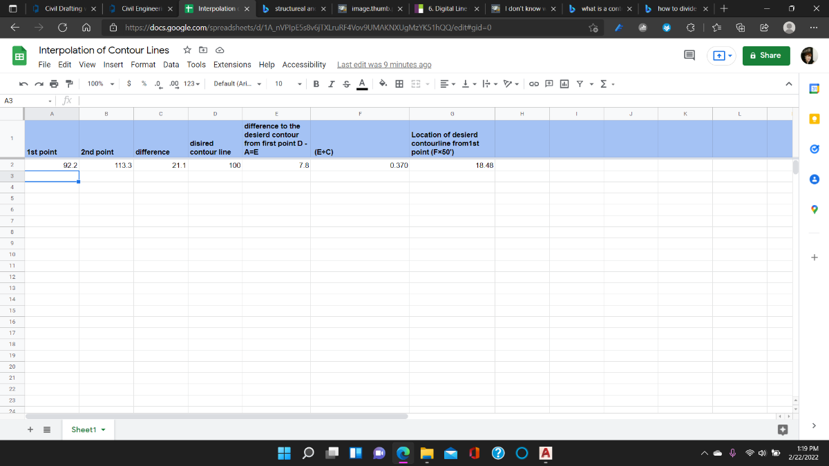

 I have my first point here on my spreadsheet. I have found where the 100 spot of the contour line is between the 92.2spot and the 113.3 spot do I also need the fine the 110 spot of the contour line also between the 92.2 spot and 113.3 spot?
If your first spot elevation is 92.2 and the second spot elevation is 113.3 then you will have a 100.0 foot and a 110.0 foot contour interval between the two points.
