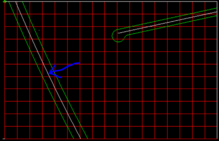

I’m working on the Structural and Civil Drafting Project, still.
I’m trying to add the Centerline for Cedar Park Drive. This is the info from the test about the Bench march and the Drive. Also, there is a grid with 50' squares 17 across and 11 down.
"The area is in a state that bases all surveys on the intersection of a meridian and a baseline for that state. Therefore, the origin (or point 0, 0) for all surveys is at that intersection, and any x- and y-coordinates tell the distance in feet from the intersection. If, for example, a benchmark is at point 11675,39532, the benchmark is 2.21 miles east of the intersection and 7.49 miles north of the intersection.
A benchmark (BM 312) exists at the northwest corner of the survey area. BM 312 has an elevation of 88.9 feet, and its coordinates are 521662, 44895."
"It's at the bottom of a hillside. The centerline radius of Cedar Park Drive is 7115.37′, and the centerpoint is located at 528257.05,47668.89. The distance from the centerline to the curb on each side is 20′, and the distance from the centerline to the right of way on each side is 40′."
I can’t get it to land in the grid. I really don’t understand how it is supposed to. I did the math. The benchmark is at 521662, 44895 and the driveway is at 528257.5, 47668.89 the grid is only 550’ by 850’ but the drive CenterPoint is 6595.05’ east and 2773.98’south of the benchmark. Why is this not adding up?

Cedar Park Drive is not a straight road.  It is an arc segment, a relatively flat arc.  The centerpoint of the arc is located outside of the bounds (grid) that is why it does not fall within the 850'x550' grid dimensions.  You do have all the necessary information to construct the centerline of Cedar Park Drive and then the width of the road as well.  See image below.  The blue arrow points to the centerline of Cedar Park Drive.

Wow, that is helpful. I was very thrown by the main description being radios. Hopefully with some experience I will see what you see. Thank you. I'm planning on continuing my education after this program. Would an algebra and geometry class help me understand this specific concept better? Thank you again.
I just did it and thank you. Now I see it!

"I just did it and thank you. Now I see it!"  Glad to hear you figured it out.
In your "spare" time you might want to take a look at horizontal curve layout only to get a sense of what is involved.  It would be a good idea to take both an algebra and a geometry class (or two) in the event you want to enter an engineering field (ex. - civil).  If you decide to further your education and attend college, I'm sure there will be an emphasis on math related courses beyond the two I have already mentioned.
Thank you, I will look into horizontal curve layouts, that is something I wanted to check out but didn't know what to call it. I love geometry so I can do that. Algebra not so excited about. Thanks, again.
