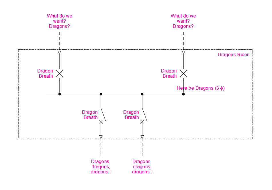

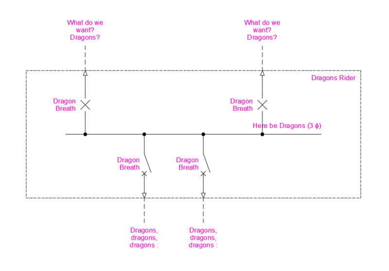

Slightly off topic, for me Electrical Single Lines I make up a blank layout via a LISP and add the texts in after, something that could be done here but would need a change of philosophy from having the data in the format above.
Was just posting this to amuse RLX.... made this up a while ago, the output below contains the default texts - something that would never be in a finished drawing and is easy to spot if I miss something:

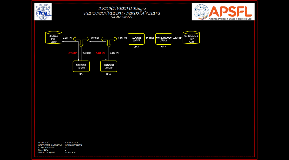

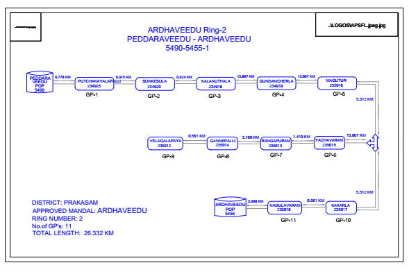

Need some updates in Lisp. So it can update  description2(CSV file) in 2nd line of the block dwg. And Some information it should attach along the SLD. APSFL Latest.csv  and I have modified border one A3.dwg to show the position of information to be filled. Attaching the final look of print image.png.9ce9a4796f89de71baf168622d750717.png
and in final output, if it will print pdf also along with dwg then it will be helpful
111.pdf

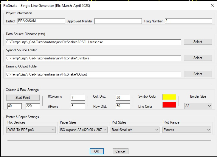

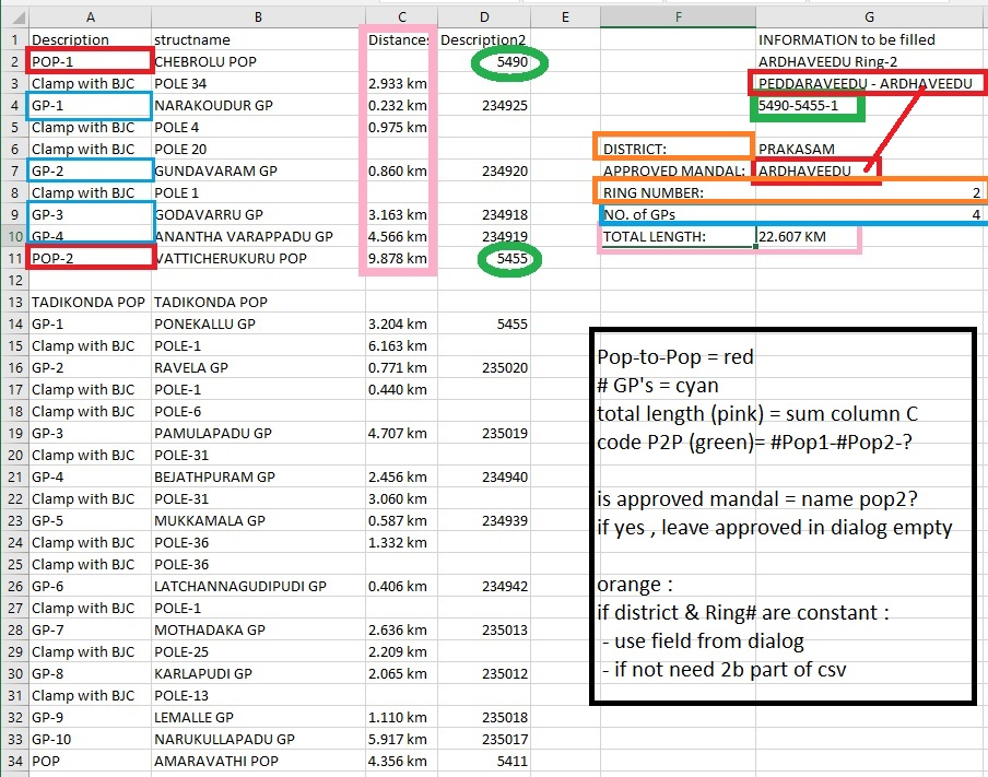

Added printer funky nationality , updated symbols with multine attributes so long names with a space in it can be spread over two lines. Updated font in A3 template. Added some edit boxes in dialog for District , Approved & Ring #. Alternatively , if this info changes per diagram (csv will be broken up from pop to pop for each diagram) this info schould be , in a standard way , whithin each pop-to-pop section.
Most info can be derived from csv , District en Ring# not (unless you add more columns as OP did in latest csv file , but there was no relation with csv data , only with image in 111.pdf. So thats why I ask either to put this info in standarized way in csv or else maybe combi csv - dialog is an option

Thanks for adding Print option...Getting some problems, in lisp its making only first 2 SLD, instead of all. And printing only 2. As for all the drawing the district, approve mandal and ring2 is not same, its safe if it takes refence from csv files. Like its Filtering from POP-POP, one SLD, it should take information from CSV and first row of POP as its information. While printing also its printing only first Drawing1, instead of all the dwg. if it will print according to its name automatically, then it will be better and stored them in same output folder instead of asking. here is APSFL Latest 4.csv the information I have filled them, it will be better if its follow csv rather than asking.  and along with line color, symbol color , if there is a text color and all the font same then it will look good.
Pimped printing a little but printing in general depends a lot on user preferences. If you select a printer it can be either a real printer or a pdf printer. App will look for pdf in printer name and takes action accoordingly. Run app on two different machines and nos problemos. Pdf's are saved in same output folder as dwg files. Whether pdf is shown directly depends on how your printer is configured. That's for you or your IT to configure , I'm certainly not coming to India to check that haha.

Mostly done, but still its doing first 2 SLD only, not the all available Data as previous your lisp was doing(in APSFL Latest 4.csv, there is data for 4 SLD)and in printing too its printing only first SLD not all. can it have landscape mode pdf?
