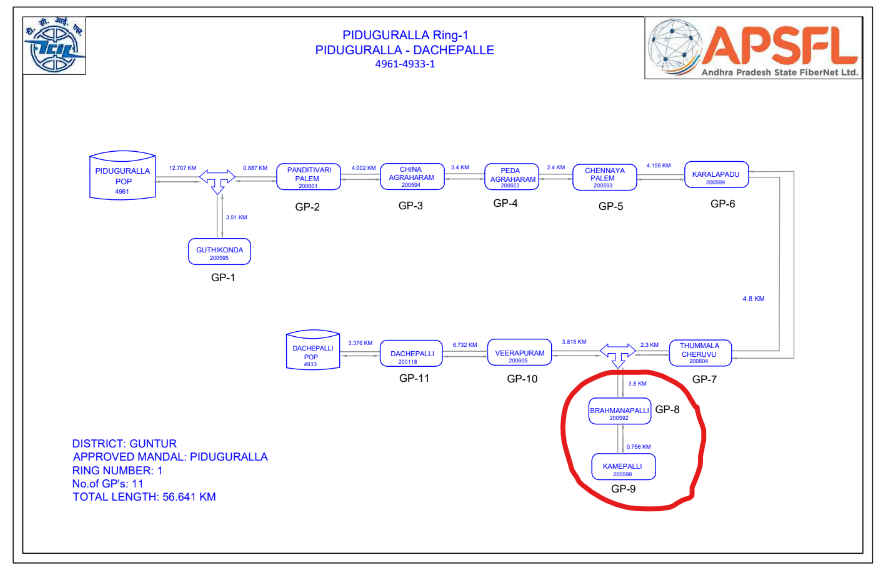

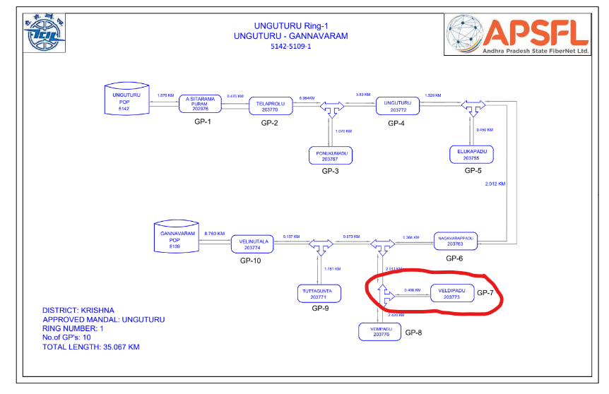

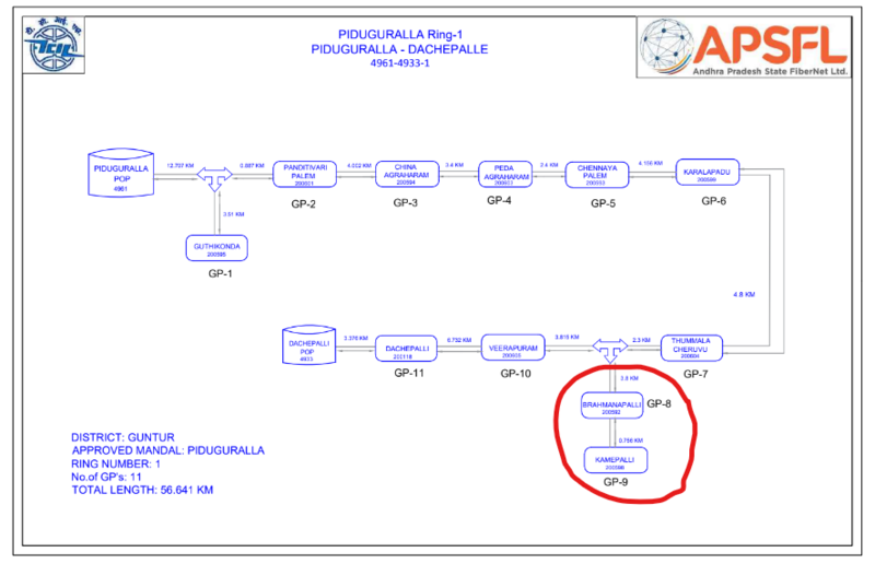

HOW can I do this type of case too? See marked part in the drawing? After JBC use how can I connect GP with another GP and then return back to JBC to execute other part?
this is more and more looking like my life's work 😁

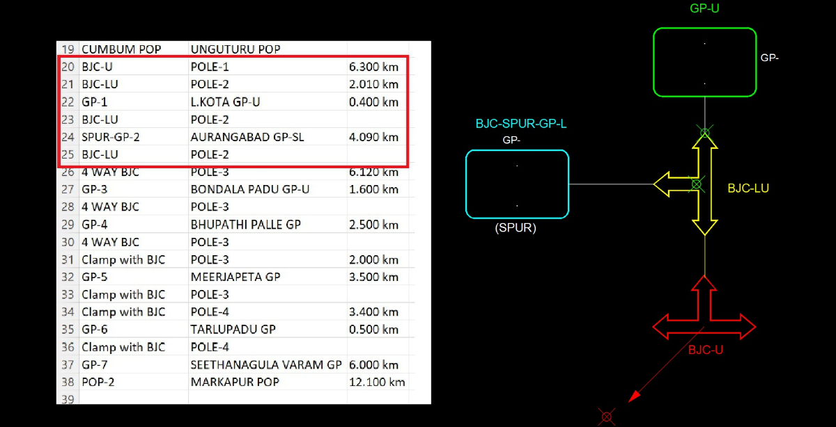

I think this all depends on how the data is presented is your csv list. Normally a clamp is shown as {clamp GP clamp} so it would be possible to change that to [clamp GP GP clamp} to handle your second image. But for your first image... i dunno... you would have to introduce a new type of clamp because when routine reads {clamp} it goes into special mode and keeps on reading until the word clamp appears again and treats it as one unit. So the entire symbol would have to consist of a horizontal clamp plus a vertical clamp with a bottom and a right GP , all in one special symbol. Current routine can't handle snake within a snake.

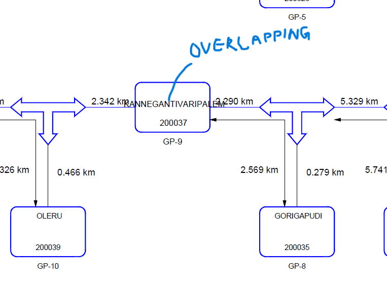

As for the overlapping , I updated attributes to mtext attributes previously but I think it probably needs a space to start a new line. Else you need (as I used before) attribute with type 'fit' and that will work but short names will get stretched out and that also doesn't look pretty.
I don't think its realistic that routine will ever be able to handle every situation you throw at it , human intervention will always be needed (if it could handle everything you would be out of a job...)

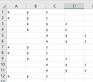

Rlx, smitaranjan when looking at problem way back suggested then that the Excel be indented each indent doing something so for a downward link, column A would be blank for each GP-8 & GP-9 2nd image above, then back to column A to continue horizontal.
A go right after a down a double indent column A Blank, Colum B blank, 1st image GP-7 could do tree answer but code is becoming more and more complex.
I would use a read excel direct I think would be easier than working with a csv. Make a list say up to say column G.
Maybe Smitaranjan has no say in the matter on how this data is presented. I dont know how the data for a double clamp looks like because I've only see the pictures , not the csv file. But it could be helpfull for each special to have its own little template like 'clamp2' for clamp with 2 GP's and 'clamp3' for situation as shown in 1st picture so when csv (or xls) is read app knows how to handle this and insert appropriate symbol. This can be very modular and easily expanded. But like I said , this might be a chicken & egg story , it all depends on the data and how it is presented. For me it makes little difference how data is presented because xls can be saved as csv and reading from a text file is less complex than to read from excel. In both cases data has to turned into a format lisp can handle. But that's just my opinion.
rlx we are both on same page with out some form of trigger to say do this how can a flat csv be read to know do option 3 now.
 Smitaranjan its your turn now.
Csv can be done as per the convenience...I'll prepare soon...May be if I add some column in csv, suggesting upward, downward, left side horizontal, right side horizontal.

Can it go after the POP too...as in this code it's ending when it found the 2nd POP, can it go beyond that and only ends at Blank Row of Csv data?

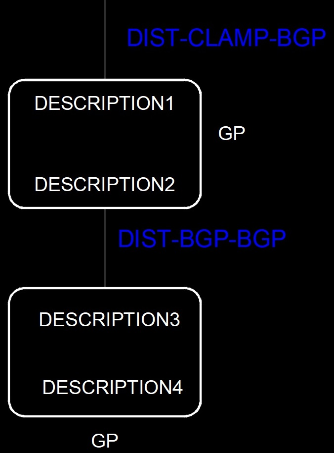

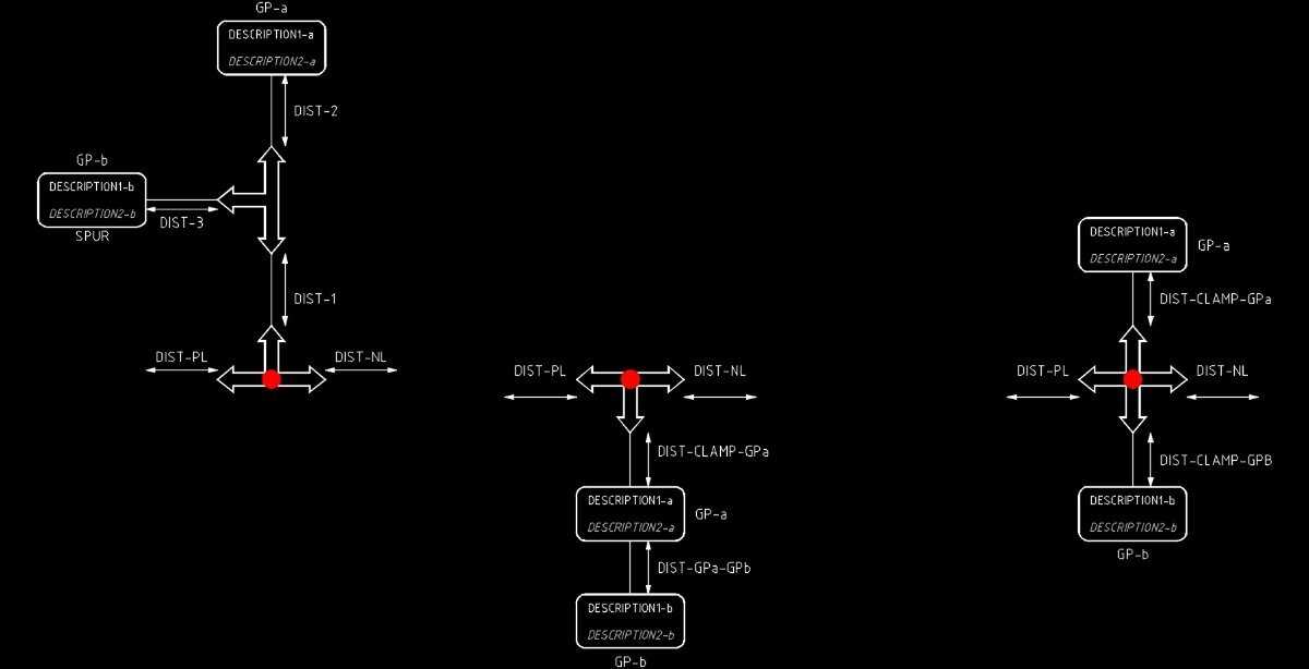

Figure 1 is built with a few of your symbols. I do have a few problems with them.
Insertionpoints :
They are all over the place (the red one is way down , green one at end of line , the blue one with a gap between it etc). App works with grid (col & row distance in dialog  50mm) and insertion point in center.
Attributes (fig 2) :
For example 2GPV-Clamp has 2 attributes with same tag (GP) How would app know which one to change if they both have same tag? It would complicate things considerably , not in the last place having to take in account lef-right / up-down. A few symbols if I recall correctly have tag placed at bottom of symbol but symbol is placed on top of line , attribute woud have to be moved.
Lisp routine is not designed to work with separate symbols the way you probably want as in the top figure. It works on a grid (row & collumn distance in main dialog , 50mm). It is nearly impossible (for me at least , maybe ChatGPT knows better) to built diagram with both left-right & up-down dynamically.
That's why I use one symbol for each branch and all attributes have a unique tag and insertionpoint in the center (shown as red dots in figure 3)
what you want is a 'snake within a snake' , dynamically in all directions , and that's not possible with this app in its present form. App would need to be able to read ahead and analyze stuff like AI and that's beyond my capabillaties at this moment.
