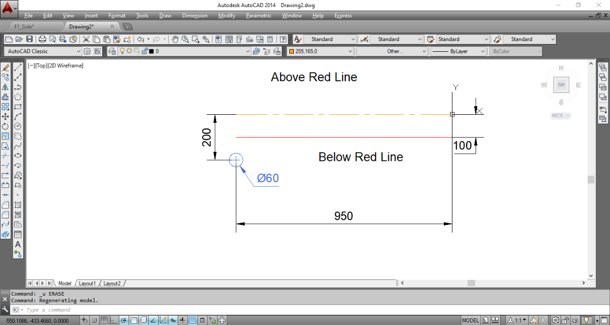

basty Posted February 1 Share Posted February 1 Hi, can someone tell me please how to draw arcs with below conditions? 1. There are arcs with radius of 2700 tangent to the blue circle and tangent to the arc with radius of 2100 which its tangent point is lies anywhere at red line. 2. The center point of the R2700 arc is above the red line and the center point of the R2100 arc is below the red line. Please show me the construction geometry. See the attached image for more detail please. Thank you Quote Link to comment Share on other sites More sharing options...
CyberAngel Posted February 1 Share Posted February 1 There is no information about where to start either arc or where to end them. Use the Tangent/Tangent/Radius option to draw construction circles. Where are these exercises coming from?? Quote Link to comment Share on other sites More sharing options...
BIGAL Posted February 2 Share Posted February 2 Draw an approximation of what it looks like using circles with correct radius and post. Quote Link to comment Share on other sites More sharing options...

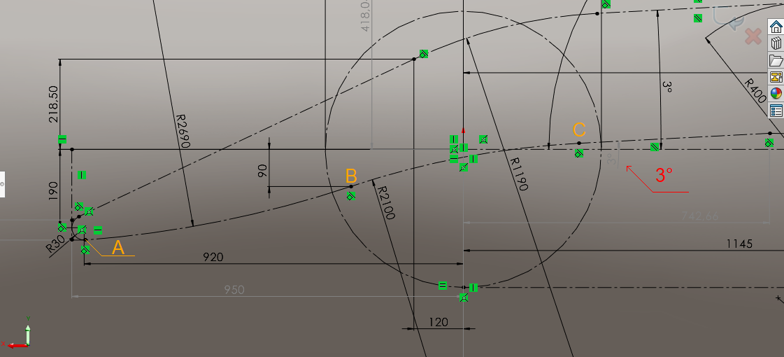

basty Posted February 2 Author Share Posted February 2 OK, this is the picture of the arcs looks like. How do you draw the R2690 arc that tangent to R30 circle at point A, and tangent to R2100 arc at point B, and the R2100 arc is tangent to 3° line? Quote Link to comment Share on other sites More sharing options...
eldon Posted February 2 Share Posted February 2 I think you will have to use Parametric constraints. You know, by offsetting the 30R circle, a circle on which the centre of the R2690 circle lies, and you know, by offsetting the 3° line, a line on which the centre of the R2100 lies. You know the distance between the two circles and you know the point of contraflexure (point B) is 90 from the base line. Set up the constraints as needed and you will get the centres of the two circles. I don't have parametric constraints on my version of AutoCAD, but as it came since AutoCAD 2010, you have all the tools to hand. I have to do it by trial and error. 1 Quote Link to comment Share on other sites More sharing options...

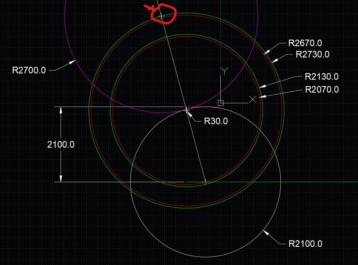

lrm Posted February 2 Share Posted February 2 (edited) There are several solutions to what you ask. For your construction keep in mnd the following: To find the center of a circle of a given radius that is tangent to a line create a line parallel to the line on both sides at a distance equal to the cicle's radius. To find the center of a circle of radius R1 that is tangent to a circle of radius R2 with a known location, create two circles concentric with R2. The radii of these two circles are (R1 + R2) and (R1 - R2). To find the center of a circle that is tangent to a line AND tangent to a circle use the intersections of the lines and circles from the previous two constructions. For your task create the white 2100 circle first. The center of the 2700 circle is at the intersection of a line passing through the 2100 and blues circles with either the 2670 or 2730 circles. Edited February 2 by lrm 1 Quote Link to comment Share on other sites More sharing options...

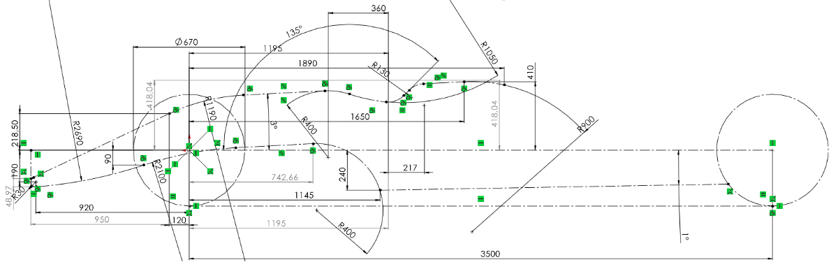

BIGAL Posted February 4 Share Posted February 4 You did not answer the request, that image appears to be one of those "exercise 23" draw this object and AGAIN often something is missing, post the full image. Quote Link to comment Share on other sites More sharing options...
basty Posted February 4 Author Share Posted February 4 (edited) 7 hours ago, BIGAL said: You did not answer the request, that image appears to be one of those "exercise 23" draw this object and AGAIN often something is missing, post the full image. Do you mean like this? Full Image What is "exercise 23"? Edited February 4 by basty Quote Link to comment Share on other sites More sharing options...
BIGAL Posted February 4 Share Posted February 4 (edited) Why is it constrained and no idea where to even start. Is this a real object for your company or a CAD Exercise out of a book etc. Edited February 4 by BIGAL Quote Link to comment Share on other sites More sharing options...
basty Posted February 4 Author Share Posted February 4 This is a real object. Quote Link to comment Share on other sites More sharing options...
basty Posted February 5 Author Share Posted February 5 On 2/3/2024 at 5:34 AM, lrm said: There are several solutions to what you ask. For your construction keep in mnd the following: To find the center of a circle of a given radius that is tangent to a line create a line parallel to the line on both sides at a distance equal to the cicle's radius. To find the center of a circle of radius R1 that is tangent to a circle of radius R2 with a known location, create two circles concentric with R2. The radii of these two circles are (R1 + R2) and (R1 - R2). To find the center of a circle that is tangent to a line AND tangent to a circle use the intersections of the lines and circles from the previous two constructions. For your task create the white 2100 circle first. The center of the 2700 circle is at the intersection of a line passing through the 2100 and blues circles with either the 2670 or 2730 circles. How do you obtain R2670, R2730, R2130, and R2070? Quote Link to comment Share on other sites More sharing options...
eldon Posted February 5 Share Posted February 5 50 minutes ago, basty said: How do you obtain R2670, R2730, R2130, and R2070? In your posted picture, I cannot see any circles that are of the size you have quoted. @Irm's diagram does not show accurately your problem. 1 Quote Link to comment Share on other sites More sharing options...
basty Posted February 5 Author Share Posted February 5 What do you mean? You should see the image that posted by lrm. Quote Link to comment Share on other sites More sharing options...
eldon Posted February 5 Share Posted February 5 1 hour ago, basty said: What do you mean? You should see the image that posted by lrm. That is exactly what I did. @Irm 's diagram is not the same as your diagram. So either you want to draw something like @Irm 's diagram, or you want to draw something like your diagram. If you want to draw something like your diagram, then solving @Irm 's diagram will not supply your answer. For example, @Irm's diagram shows the r2100 arc tangential to the R30 arc. That simply does not happen in your diagram. Quote Link to comment Share on other sites More sharing options...
