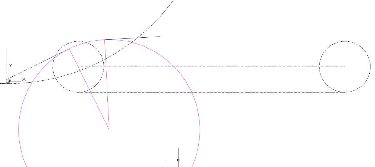

Now for some thinking.
The top of the 30 circle is trimmed between a line and the 2690 circle. This line starts at a point (920 - 120) right and (190 + 218.5) upwards, Draw a line from this point to the 30 circle using tangent snap at the circle.
Working out wards from this line, I don't see the point for the centre of the 1190 radius arc, but we can work it out. Draw a circle (circles are your friend),1190 radius, anywhere, and copy your last line to the centre of this circle. Extend this temporary construction line to the circle circumference and rotate it 90 / 270 degrees so it intersects where you might guess it should be. This is the start of the arc from the last line drawn. Move this circle / line temporary lines intersection to the end of the last line drawn
Now try and repeat the same for the 3 degree line continuing from here and this should give you something like this:
A lot of these, and CAD in general, is  just finding a start point and working through the problem systematically.
Have a go at getting this far and further, asking specifically where you get stuck

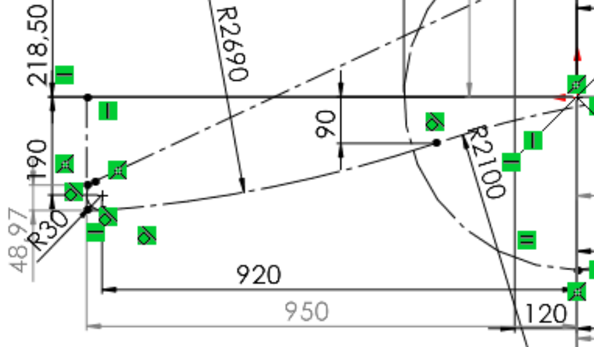

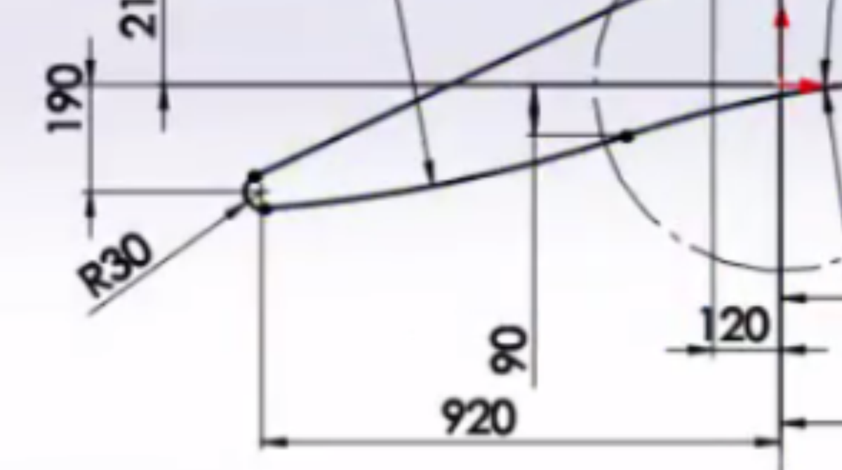

On another of the various pictures posted, the tangent point of the R30 circle and the R2690 circle does not seem to be vertically below the centre of the R30 circle.
Perhaps it is easier drawn in SolidWorks than AutoCAD. The constraint images are quite confusing and block vital parts of the linework image.
Yes, you're right.

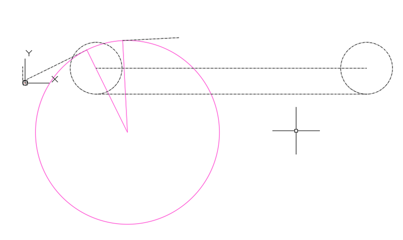

1 hour ago, Steven P said:
If that is the case then ignore that circle for now, it should become obvious later, Draw the entities where the locations are known.
These should be easy to locate and draw:
How do you draw that magenta circle? Is that the R1190 arc?
Edited by basty

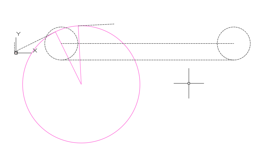

Magenta circle, has a radius of 1190 (from the drawing). The line 30 radius circle to magenta circle is a tangent to this circle - so geometry  that a 90 degree angle to any tangent on the circle passes its centre. Rotate and copy the line by 90 degrees and also extend it to 1190 long, this is the centre of the circle. You can use the extend command or draw another temporary circle 1190 radius at its end and extend to that ones circumference, then delete the temp line.
The top line is the reverse, from 1190 circle centre the magenta upright line is rotated by the angle, and then rotated and copied 90 degrees to get the next one
After that look for any other points you can draw - there are a few more without too much thinking
After that post a snippet of where you are at for the next hints

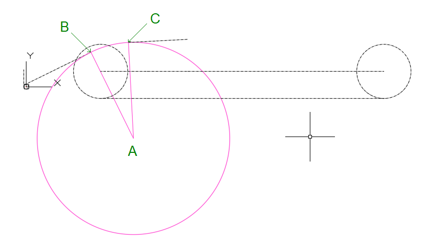

so point C is similar method to point B, the grey line hits the magenta circle at a tangent, a right angle to this line will pass the centre of the circle - point A. We know from the map that this grey line is angled at 3 degrees, so..... draw a vertical line from A to the circumference or further, and if it makes it clearer the grey line, then rotate it so the grey line is at 3 degrees (rotate 3 degrees.....)

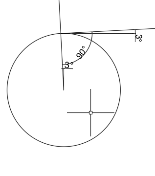

the sketch below might demonstrate better how circles work.

Is this the magenta circle?
Yes, it is taken from that, but showing the way it works above, a right angle from line centre of circle to circumference will be a tangent to the circle - which is the fundamental behind a lot of this exercise to understand I think
