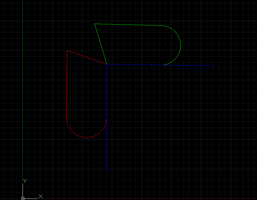

Hello.

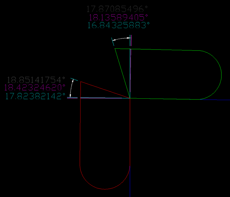

I have 3 objects representing 3 walls of "cube" (corners are not 90 degree). How can I align them so 2 sides of each object is parallel to each other object?
I don't know the elevation, so how can I align red and green corners and keeping both objects on blue?
Thank you.
3dcorner.dwg
Edited by vanowm
Updated the drawing file

I think you might have misunderstood my dilemma...the shapes are already drawn, they can't be changed, what I'm trying to figure out is how to rotate red and green plines so their edges meet.
If blue pline represents floor, then red/green are the walls, I need "stand" them up at proper angle.

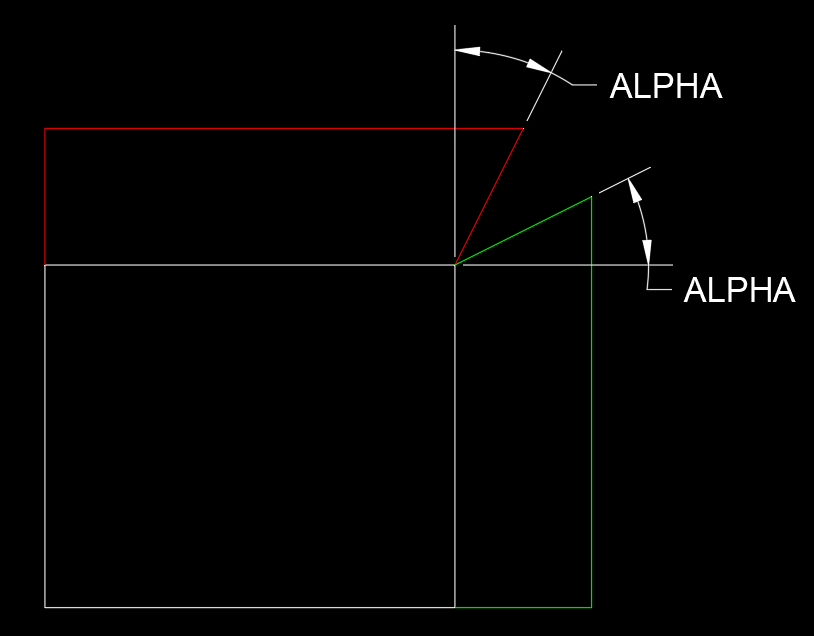

Given a flat pattern that looks like this.
The angle theta needed to rotate each tab up about it edge so that the ends are coincident is:
THETA = ACOS(TAN(ALPHA))
Which yields the following.
  • Thanks 1
Use the rotate3d command with the 2 point option. After selecting the geometry you want to rotate pick 2 points on the fold line then enter the angle theta.

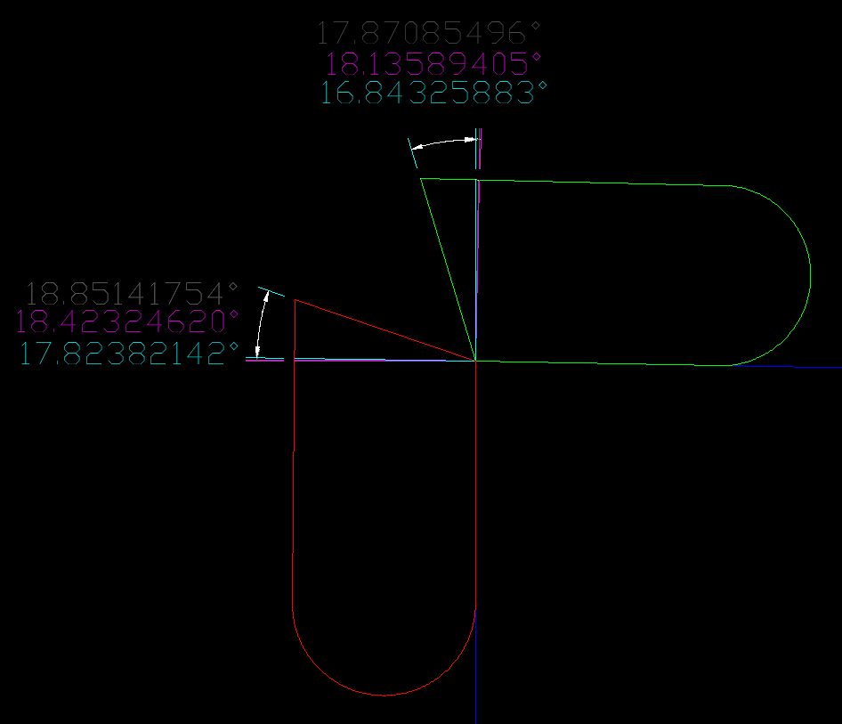

This almost worked, but top corners don't meet.
Is ALPHA angle relative to the bottom (stationary) edge, the top or relative to the angle between the walls?
I'm getting 15/32" deviation with relative to bottom, 19/64" with relative to top and 9/16" with relative angle between the walls.
The THETA I'm calculating with this:
(rtod (acos(tan (* pi (/ ALPHA 180.0)))))

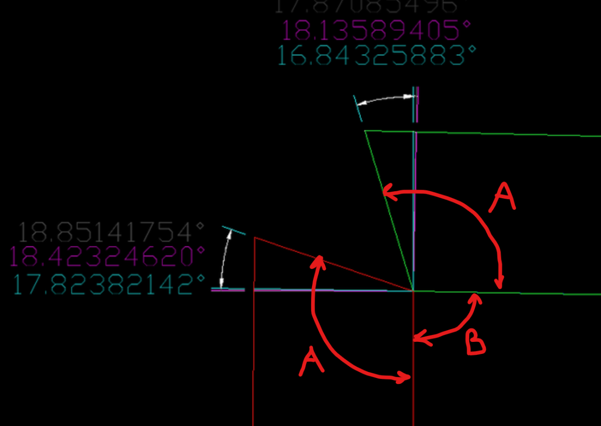

@vanowm When I derived the formula I assumed that angle B was 90° and that ALPHA was equal to (A - 90) in the following drawing.  ALPHA should be the same for both tabs.   Is B not 90? Please post you drawing.
Yeah, B is not 90. The drawing is attached to the original post.
So, if it's based on the B angle, then the blue numbers should have worked?

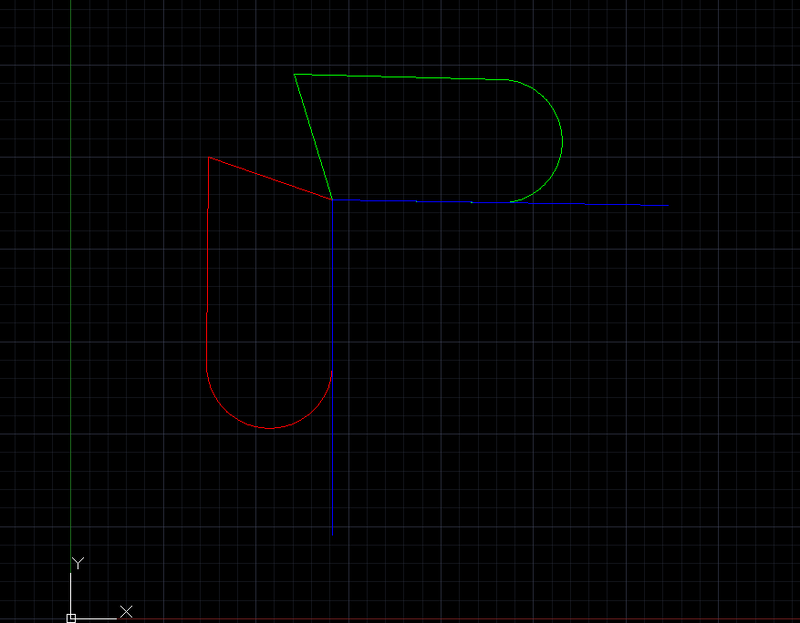

Something wrong with the forum, I can download it while logged in, but as a guest it shows as "unavailable"
Let's see if it works in reply.
3dcorner.dwg
Edited by vanowm
@vanowm  I've modified the formula to handle corners that are not 90°.  Here's the revised formula for theta, the bend angle.
THETA = acos(tan(ALPHA) / tan(90 - BETA/2))

Note that in your drawing the angles for the tabs are not equal.  They should be.

It still doesn't make the corners touch...1/2" gap. As of not equal angles - this shouldn't matter, they would just have different lean angle (THETA)
I know the source of the error but not sure how to fix it.  I assumed that the edges would be verticaly in line with the BETA angle bisector. They are not if there are two differet angles for ALPHA.   I'll have to give it some thought when I have some time.
The following should get you closer.
THETA RED = 71.043

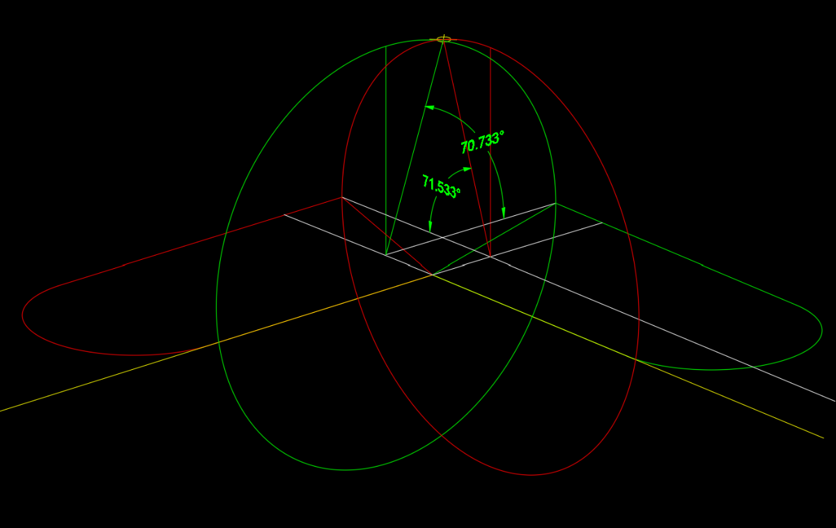

I think I have an apprach that will yield a solution.  I determined the angles graphically in the image below. The green and red circles are on planes perpendicular to the fold axes of the red and green polylines. The yellow point is one of two intersection points of the two circles.  I used osnap nearest (zoomed in) to approximate the point.  This point can be used to determine the two rotation angles.
theta red = 71.533°
theta green = 70.733°
These angles yield pretty good results with the end points within 0.08.  I think even better results could be achieved with a more accurate calculation of the intersection point of the two circles (note, their planes are not perpendicular to each other).    I'll try to write some LISP code to determine the intersecion point of two circles on non-parallel planes.
The following program will accurately determine the fold angles and then rotate the two objects so that they meet at a common seam. The user must specify the followinng points.
The folding axis for polyline A is a line passing through the corner point and fold line point A. Likewise, the folding axis for polyline B is the line passing through the corner point and the fold line point B.  The seams are defined with points A and B.  The two polylines must lie on the world XY plane to start.
After execution the polylines are rotated about their axes so that the seams are collinear.
