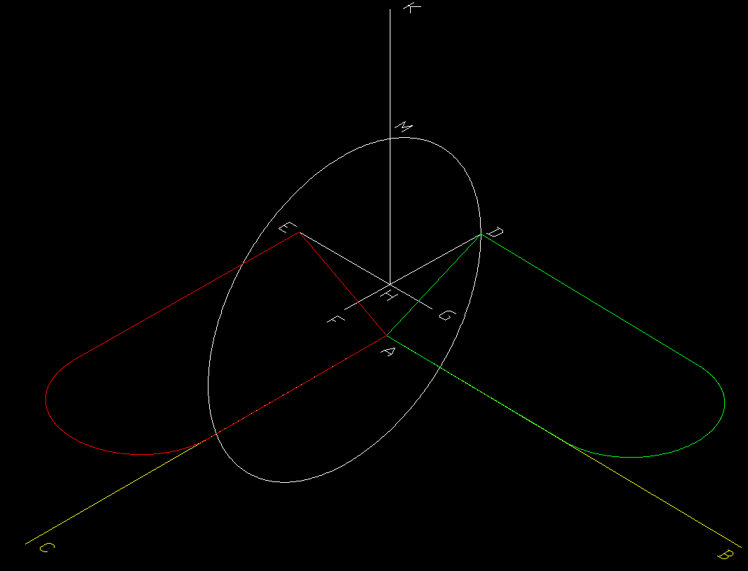

screen.thumb.png.a0922d509a3b2c41f2bb0b9969cef802.pngYou can solve this graphically without knowing any angle, using align command. The only requirement is that distances A-D and A-E are equal (attached drawing).
Determine the point in space where points D and E will meet:
Draw a line D-F from point D, perpendicular to line A-B.
Draw a line E-G from poine E, perpendicular to line A-C.
Lines D-F and E-G intersect at point H
Draw a line H-K from point H, then type in:  @0,0,30 + Enter.
Set UCS to 3 points - H, D and K.
Draw a circle - center = point F, radius at point D.
Just drawn circle intersects line H-K at point M.
Start "align" command and select green figure.
First source point = A, first destination point = A
Second source point = B, second destination point = B
Third source point = D, third destination point = M
Align the red figure - A to A - C to C - E to M

@paulmcz
Thank you very much! I've tried this approach before posting, but failed because I draw H-K line to the size of A-D side and aligned the sides to its end. Apparently the intersection of the circle with that line is the key.
And a little note, the number 30 in the tutorial is an arbitrary number, preferably it should be not smaller than length of the A-D/A-E side, otherwise circle won't intersect it and an additional step would be needed to extend it.
Would you mind add a screenshot to your post, so it would be easier to following without opening the drawing.
For A-D/A-E with different lengths, a possible solution is to add "virtual" corner on the longest side (A-D or A-E) by drawing a circle from point A to E (or D whichever is the shortest, white circle in the screenshot) and where it intersects on longest side become D (or E) point:
Edited by vanowm
I made line H-K 30 just to make sure it is long enough to intersect the circle and as you mentioned, to avoid the extra step of extending it. It could actually be any length as long as we are able to find where it intersect with the circle.
I added a screen shot to my previous post but somehow, compared to yours,  the quality is not good. How do you do it? Yours is perfect.

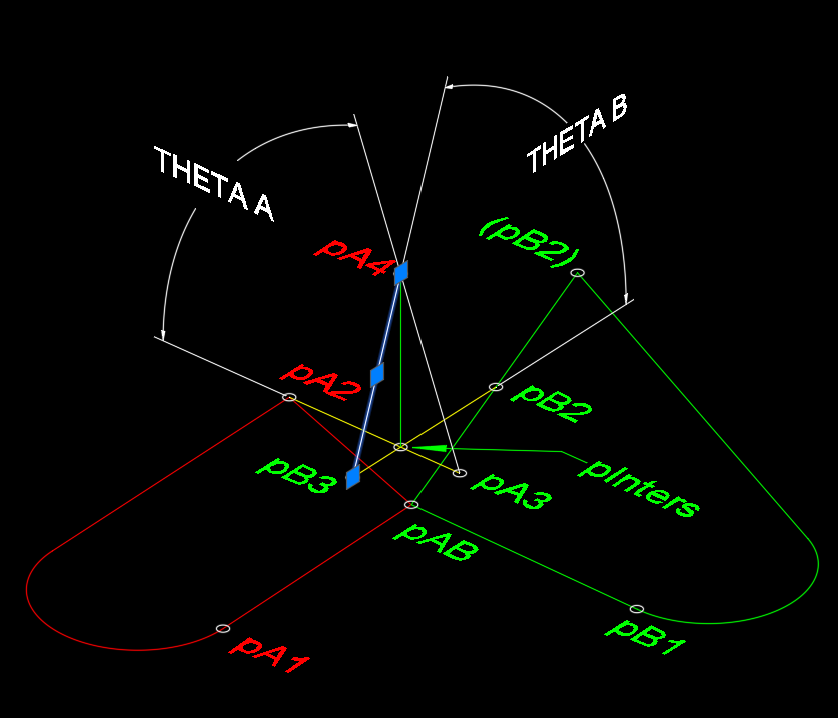

@vanowmHere's a diagram that shows the points I used in my program.
pA3 is the projection of pA2 onto the line define by pAB and pA1
Using vector algebra:
pA3 = pA1 + (dot product of vector (pA2 - pA1) with unit vector (pAB-pA1))
pB2 is redefined to be the same distance from pAB as pA2 is from pAB.
pB3 is the projection of pB2 onto the line definde by pAB and pB1
pInters is at the intersection of pA2 to pA3 and pB2 to pB3
The Z coordinate of pA4 (Az) can be determined from the right triangle  defined by points pInters, pA3, pA4 since we know the length of two sides of the triangle; pInters to pA3, and pA3 to pA4 which equals the distance from pA2 to pA3. A dot product of unit vectors of these two sides of the triangle yield the cosine of THETA A.
The calculations for B are done in a similar manner.
My code has some leftover artifacts from the development process.  E.g., rB and Bz can be removed since the relocation of pB2 makes rB = rA and Bz = Az.
