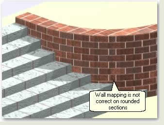

The illustration below demonstrates what happens when a brick material is assigned to a rounded wall created by extruding a closed spline. The mapping is 'Box'. Although sometimes this can be acceptable at a distance the bricks elongate around rounded corners and do not follow the curve correctly

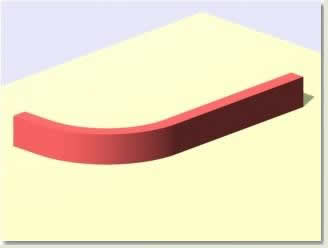

- Select Wall section. The resulting loft forms the wall. Select the loft and rename it Wall 01 lofted

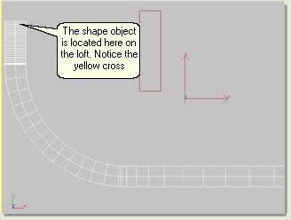

- In the top viewport move the cursor to where the yellow cross was positioned and notice the cursor changes to a cross. Left click while the cursor is in this position to make the Shape Commands rollout active (they turn from greyed out to black text). These commands automatically position the shape around the path line
![](/tutorials/3ds-max/loft_mapping/kf491012.jpg)
- Maximise the user viewport and press Top button, then the Left button. Notice that the shape and the wall moves up to its correct position. Experiment moving the shape around the path line before putting it back to its correct position. Finally in the modify list click Shape to come out of sub-object mode

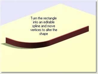

- Select Wall section (the rectangle). In the Modify Panel change the length and width of the rectangle and notice how the wall's width and height changes. There is a problem here though as the height and width are altered from the default central pivot point of the rectangle. To solve this, select the rectangle, open the Hierarchy Panel under 'Pivot' press Affect Pivot only. Use endpoint and pivot snaps to snap the pivot to the bottom left corner of the rectangle. Right click to come out of the command then with the rectangle selected right click over it and turn to editable spline
- Select the wall loft and re-apply the rectangle shape which is now an editable spline. The shape should position itself on the path exactly how it should do without re-positioning it
- Select Wall section rectangle again and change its length and width by going to vertex sub object mode and moving the vertices up or across with the transform gizmo. The wall will change height and width, but this time will stay in the correct place

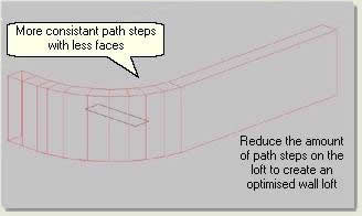

- Select Wall loft 01 and right click over it to look at its properties and ascertain how many faces it consists of. With 0 shape steps and 12 path steps the wall has 548 faces. For a small wall this is quite a load on the scene. To optimise the wall loft the type and number of vertices on the loft path may need editing thus:
- Select Wall 01 path spline and Isolate Selection. In the top viewport notice that the spline only has 6 vertices and that two of these are very close together
- In vertex sub-object mode select the two vertices close together and press Weld on the Geometry rollout
- Go to segment sub-object mode and press Refine button. Move the cursor over the spline and insert 7 vertices on the curve. The spline now has 12 vertices
![](/tutorials/3ds-max/loft_mapping/kf491030.jpg)
- Still in vertex sub-object mode select all the vertices on the curve, exluding the vertices at the end of the straight segments (these need to be Corner vertices). Right click over a red selected vertex and select Smooth from the vertex type quad menu
- Similarly, turn all the other vertices into Corner vertices
- Come out of sub-object mode and Exit Isolation. The wall loft now has more even path steps
![](/tutorials/3ds-max/loft_mapping/kf491032.jpg)
- Select the wall loft and in the Modify Panel change the path steps to 0. Notice that the number of faces has been reduced to 84 without a dramatic reduction in quality. If necessary, increase the number of path steps to 1
