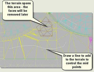

- Draw a line in the Top viewport in the middle of the terrain to control the mid points of the terrain thus:
![](/tutorials/3ds-max/planting_beds/planting 004.jpg)
- Add the line to the Terrain Object by pressing Add Operand

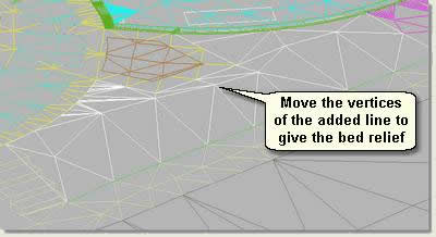

- Move the vertices of the line sub-object up and down to give the bed form and relief
- Convert to Editable Mesh

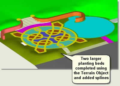

- Finally, remove unwanted faces spanning the paving area from the planting bed in face sub-object mode
- Repeat the operation with the last and largest planting bed planting bed

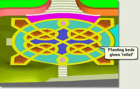

Finally add relief to the inner planting beds thus:
- Select the inner planting beds. These are called Bdy maze whole.02 if not renamed
- Isolate Selection
- Subdivide to a value of 0.3
- Move up to a value of 0.1
- In Edge sub-object mode select the open edges and move the edges down 0.1
- Apply a Smooth modifier and turn smoothing Off
![](/tutorials/3ds-max/planting_beds/planting 010.jpg)
