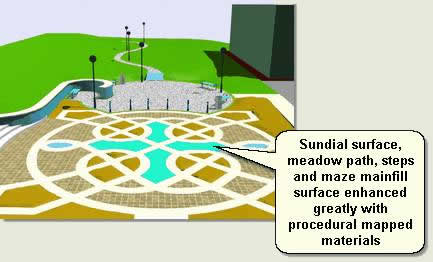

Procedural maps use computer generated effects and are applied to materials for many different purposes. They have to be scaled and positioned on the object using a UVW Map modifier or a Map Scaler modifier. In this exercise you will produce and assign a gravel material for the sundial surface and meadow path using a Noise procedural map and a step and flag material for the steps and flags using a Tiles procedural map

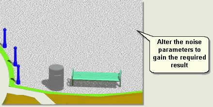

- Noise Parameters rollout > Enter Size: 3
- Select Sundial surface and Assign Material to Selection
- Apply a UVW Map modifier to the surface and change the Length and Width to 1 after making sure Real-World Scale is checked Off
- The material should show in the viewport. If not, in the Material Editor press the Show Map in Viewport button
- In the Material Editor alter the Size parameter to gain the required result after test rendering

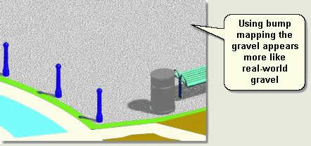

Fine tune the material and add bump effect
- Change the Size to 0.01

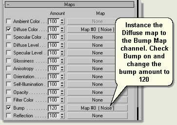

- Go to the Material level (top). Maps rollout.
- Left click and drag the Noise Map in the Diffuse channel down to the Bump channel. Check Bump On and move the spinner to about 120. Notice when rendered the surface appears more like gravel
NOTE: Bump mapping makes lighter areas stand out and makes darker areas recede. This has the effect of making a bumpy surface as in real-world. This is often used for brick walls and flags to make the bricks and flags stand out from the mortar and not appear 'flat'

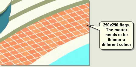

- Advanced Controls rollout > Tiles Setup Enter 4 in both Horiz. Count and Vert. Count. This means that when the UVW Map modifier is applied and length and width set to 1, the flag units will be set to 4 per metre, or 250mm per unit
- Make sure (as always) that Show Map in Viewport button is on
- Select Paving below steps in the viewport and Assign Material to Selection
- Apply a UVW Map modifier to the surface and change the Length and Width values to 1. The flags in the viewport should look like 250mmx250mm flags

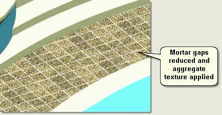

- Mortar Setup > Change the Horizontal and Vertical Gaps to 0.5
- Tiles Setup > Press the Map button to the right of the mortar colour swatch > Choose Bitmap > Select Aggregate 04 in the tutorials Map folder. This applies an image texture to the brick material
To alter the size of the aggregate image in the brick map you need to alter the tiling at the texture map level. This is further down the material hierarchy (remember where you are because you will need to go back up and down)
- Press the Map button to the right of the mortar colour swatch. This will now have Aggregate 04.JPG label on it. This will take you further down the material hierarchy to access this map's parameters
- Coordinates rollout > Change the U and V tiling both to 2. Press Show Map in Viewport button to display the tiling change in the viewport

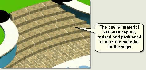

To make a material for the steps you will use the same material as the flags (copied), resize the flag units to 900mm and use the UVW Map modifier to position the flags correctly
- Ungroup Top Steps. Select TOPSTEP1.01
- In the Material Editor copy the Flags-red-tilesmap material to the next sample window by left clicking and dragging to the next available window. Then rename the material Step blocks tilesmap
- Select TOPSTEP 1 and Assign Material to Selection
- In the Bricks Map parameters change the Vertical Count to 0.1 and the Horizontal Count to 1. This will mean that no gaps show across the steps as would be the case in construction
- Apply a UVW Map modifier and change the Mapping to Box and the Length, Width and Height to 1
- Use the UVW Map Gizmo to move the material left or right in the viewport
- Repeat this procedure with all steps (including the bottom steps) to produce step blocks that are randomised left to right as below

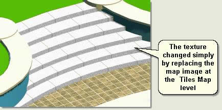

- Re-visit the two materials for paving flags and step blocks and change the textures by going to the Tile Map level and pressing the Map button to the right of the Tile Texture colour swatch. Under Bitmap Parameters rollout press the Map button at this level and navigate to and choose another texture map

- Finally, apply the Flags-red-tilesmap material to Maze mainfill using the mapping procedure outlined above
