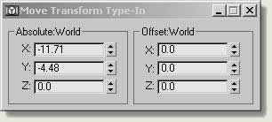

  • With the button in Select and Move mode (button is orange) right click over the button. This displays the Move Transform Type-in floater
This 'floater' is used to accurately move objects by typing values for X,Y,Z
  • With the floater still displayed press Select and Rotate and Select and Scale Note that the Transform Type-in dialog changes to suit. Close the Transform Type-in floater by clicking on the X at the top right of the window

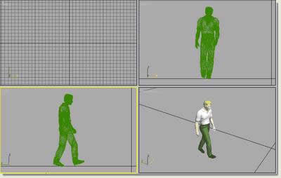

Viewports
The viewports enable you to view any part of the scene or any part of an object and are highly configurable for many modelling purposes. The configuration of viewports and how to navigate in 3D space is explained later in the tutorials

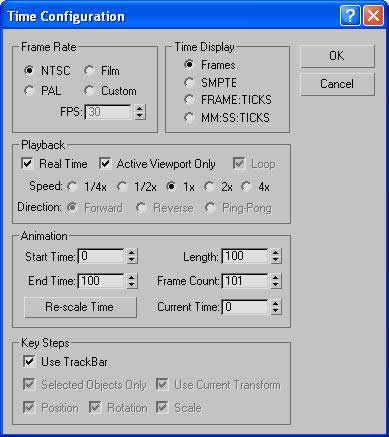

Time Configuration dialog
  • Press Time Configuration to open the Time Configuration dialog. This is where the number of frames available and number of frames per second playback are configured
