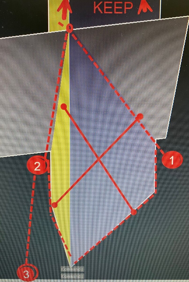

  1. I have tried to slice the lower red section using SLICE command with 3 points as a cutting plane. I selected those points per picture then selected the top side that wanted to keep but the object remains the same. Could you suggest me what I have done wrong. I know that there are other ways to do but just want to know this easy one. Thanks
