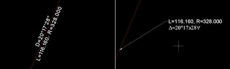

Curve Labels in Dragged State, changing symbology
Bertdorf3 posted a topic in AutoCAD Drawing Management & Output
Hi all, I'm drafting out plat info, property lines, and labeling curves. I changed the Curve Label Format to DDMMSS and that worked, but when I drag it (leaving it as Stacked Text) the minutes and seconds symbols change to backward E and upside down A... any ideas how I can prevent that? Autocad Civil 3D 2017- 3 replies
