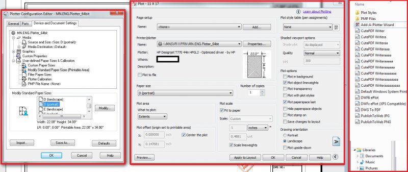

I plotted to Adobe and from there plotted without any issues. But doesn't plot properly in ACAD. I get the same issue if I try to do Window. Here is a screen shot of my plot:
I would uncheck "Fit to paper" and make my scale 1:1 since the sheet size you are plotting is smaller than the paper size you are using.

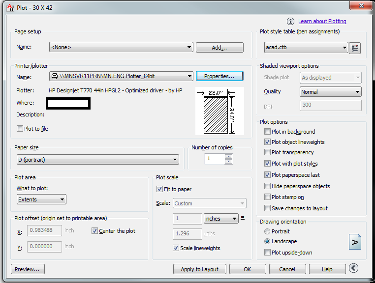

Why are you plotting to "Extents" as shown in your previously posted image if you are plotting from a paper space layout? Shouldn't that read "Layout" instead?

When I print the 17 x 22 layout, it prints that size layout on a bigger piece of paper (22 x 34) giving it about eight inches of blank space at the top and to the right of the titleblock. Its our standard to use extents to fit our titleblock and fit to page. I want the 17 x 22 to be fit to a 22 x 34 page, so the layout will be bigger than if I plotted it to 17 x 22. Does that make sense?

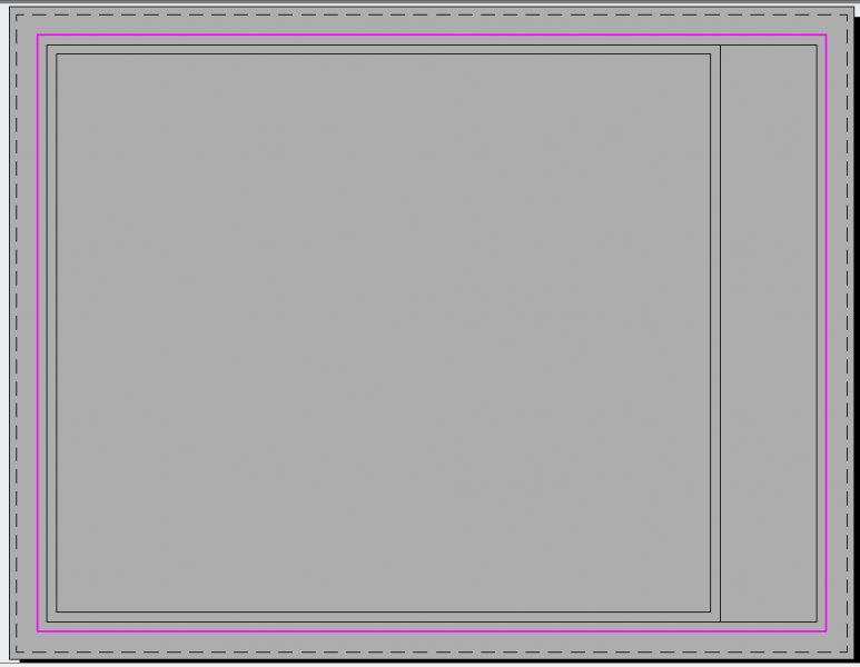

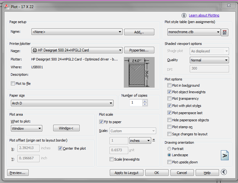

Well I tried it your way and got the same results. So I got to thinking about a way to cover as much of the 22x34 sheet with your drawing and came up with this approach. Draw another box around your border and leave about 1/4" space between the two. Looks like this. Note: this box (magenta colored) will be used for making your picks for the "Window" option in the plot dialog box.
Then use the following plot parameters.
I tested it and it works.
If you don't like this method then you will have to come up with one on your own.
Best I can do at the moment.
It should go without saying that the plotter name will of course be different and maybe even the paper size where I have "Arch D".
On some plotters you have to go into the pc3 file and tell it the width of the roll of paper being used, perhaps you are telling it you have 24" in properties when you actually have 22".
I'm not very familiar with PC3 files, although I know that there is no PC3 file for the plotter, only for some other ones that my coworkers must have set up. When I select the plotter in the plot dialog box, I can go in and check the properties that are set up for the plotter.
[ATTACH=CONFIG]33550[/ATTACH]
Sorry, it is in the printer properties itself, go to windows, start, devices and printers, right click over your plotter name, check device settings tab for width of paper loaded. I have a 770HP and that is where I find it here.
ANSI D is not an option for some reason. However there is an Oversize D which is also 22 x 34 and the same thing happens.
The printer says the paper loaded is 22" (in the properties).
