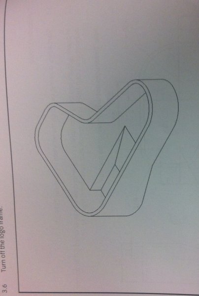

My Tutor has recently given me a iso drawing to complete.
I think the drawing is correct but would really appreciate if either someone could check the drawing for me.
Better still if someone could complete the drawing from scratch i could overlay it and see if i have made any mistakes.
It not a large drawing so im sure if your good on ISO's it will be quite easy.
I would really appreciate it if someone would come to my aid.
Thanks
Matty

topgunmatt
Hi
I have attached the files if someone can help
ISO-Help.dwg
Share this post
Link to post
JD Mather
At first look - it looked pretty good.
But on closer inspection -
-you are a long way from origin and outside of border.
-I would place border in paperspace layout.
-I placed a couple of isocircles and yours did not match radius of mine
- you have several places that aren't trimmed correctly.

topgunmatt
Thanks, i mainly concerned about the accuracy of the model itself as i have a border/template to add later.
Can you highlight the drawing errors and send back to me???
Im really stuck !!
Share this post
Link to post
ReMark
Your radii are wrong and in the plan view that rectangle is not only in the wrong position it also requires at least one extra line. Try again.
See where it says, for example, R30? That is the radius for the segment of the circle on the outside of the object. In your drawing the radius is 33. Same goes for all the others.

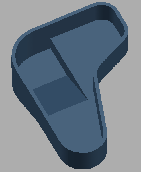

ReMark
Maybe this view will be better.

JD Mather
Well just for fun I gave it a go as a 2d isometric. Not an impossible problem (I am confident in my solution), but I will make a small wager that your instructor can't do it absolutely correctly. (if you don't give the instructor a warning that I am checking, I might even be willing to make the wager even if the instructor does know I am checking their "solution")
I suspect by the time the instructor finishes the "solution" he/she will say, now let's move on to the modern 3D tools.

topgunmatt
Hi JD
Thanks for your reply, can you post your Iso dwg file.
I'm really looking to see if someone can post there ISO so I can use it as a proof check.
Can you help?
In willing to PayPal someone for there time if they can produce an exact replication of the scanned picture in the previous page.

ReMark
Your plan or top view of the object was wrong therefore I expect your isometric would be wrong too (and it was). Did you redraw it or not?
Share this post
Link to post
ReMark
I believe this is the isometric view you are looking for.
Share this post
Link to post
