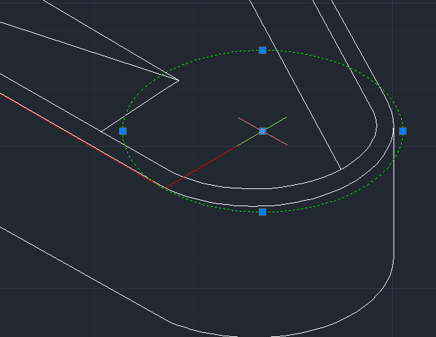

I think it is close. I'm getting some ever-so slight variations in lengths. Example: the straight side length that should be 80 is being shown as 79.7591 which seems a bit odd. When I lay an isocircle with a radius of 20 over yours it appears to be a very slight difference where it meets up with the line that is supposed to be 80 units long. It's like the line is not quite tangent to the circle. Does your teacher deduct points for these kinds of differences?

I drew a little of the top in magenta, looks like you are guessing at a lot of stuff. Use the Ellipse, Isocircle for all of the radius. Copy or move in an Iso, never use offset.

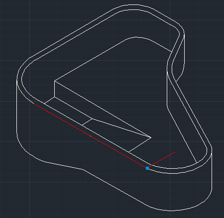

Here is how you can check your drawing.
Change the active color to some other color (like red).
Change to Isometric snap (I don't understand why your drawing doesn't open with isometric snap setting on?).
Hit F8 to turn on Ortho (if not already on)
Hit F5 to set your cursor to the top plane.
Draw the 80mm line from the endpoint of the arc as shown in attached.
Draw 20mm line perpendicular to the 80mm as shown.
Attach the file here.
If you follow my steps step-by-step you will get the solution
I'm bettting you will give up long before finished (challenge).
Note: when you draw the 80mm line do not click on the second arc - move your cursor well beyond the arc and use direct distance entry. AutoCAD will take care of the distance. Make sure you are tracking along the 150°.

I have created most of the radius lines with elipse (isocircles) but when i click on properties of the line it shows a minor and major radius?? i dont understand this??

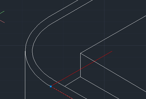

I'm still waiting on two lines. That simple.
OK, just one line.
Set to isometric grid.
Hit F5 to go to top plane (but doesn't really matter whether top of front for this one line.
Click on screen for start point of line, move mouse in direction of the 80mm line and type 80, hit enter.
Save the file and attach it here.

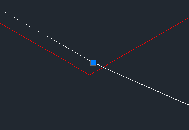

Zoom in to the intersection of the two red lines - note that the location is different than on your original.
draw an ellipse isocircle radius 20 with center at end of short red line.
Zoom in and check the intersection with the 80mm line.
draw 30mm line at other end of your 80mm line as shown.
draw 30mm radius isocircle centered at the end of this line. (not shown)
Attach your file here.
