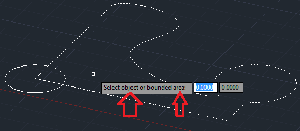

rkent Posted January 23, 2014 Share Posted January 23, 2014 Use closed plines, so for existing plines use the pedit command, select the Close option. Now try PP again. Also with PP be sure to select in the middle of the bounded area rather than picking on the object edge. Quote Link to comment Share on other sites More sharing options...

ntremaglio Posted January 23, 2014 Author Share Posted January 23, 2014 ok so I fixed the problem and found the original cause. rkent you were right, i wasnt selecting the middle of the bounded area but rather the actual boundary itself. So thanks everyone. Quote Link to comment Share on other sites More sharing options...

JD Mather Posted January 24, 2014 Share Posted January 24, 2014 When I run PressPull (2014) the prompt is to select an Object or an Area. If I select an open Object I get a surface. If I select a closed Object (a closed object being defined as one entity - say a closed polyline). If I select a bounded Area I get a solid. As seen in image - the bounded area can be comprised of a Line, Polyline, Circle, Arc and Spline. Quote Link to comment Share on other sites More sharing options...
