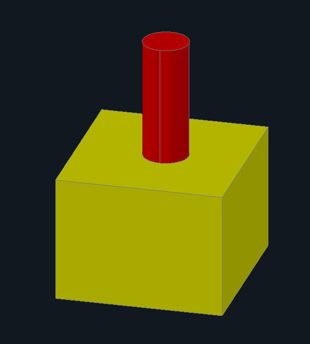

Berzerker Posted August 17, 2020 Author Share Posted August 17, 2020 Seeing's how this is in the solid model section I got another question. Lets say you wanted to put two different colors as a solid. When I union them it turns all but one face the color of the other one. Can I make it two different colors when they're joined. This place needs a "Who's online" Thanks Quote Link to comment Share on other sites More sharing options...

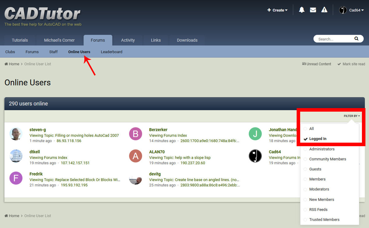

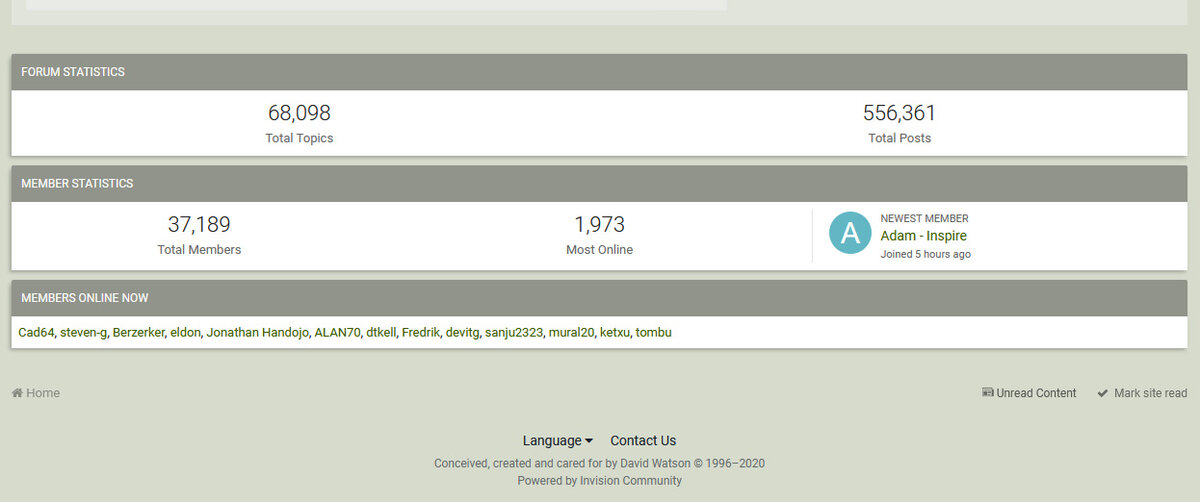

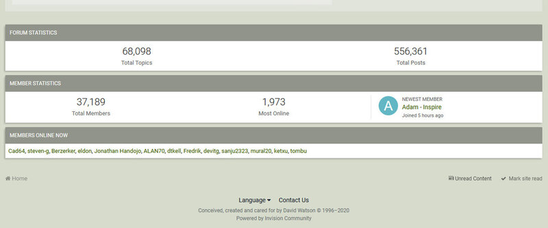

Cad64 Posted August 17, 2020 Share Posted August 17, 2020 I don't think you can retain the color information when you Union. The object will take on the color information of the first solid you select. As for Who's Online? Go to the main page and scroll all the way to the bottom. Quote Link to comment Share on other sites More sharing options...
Cad64 Posted August 17, 2020 Share Posted August 17, 2020 18 minutes ago, Berzerker said: This place needs a "Who's online" You can also go to the "Online Users" tab and filter by "Logged In" Quote Link to comment Share on other sites More sharing options...
Cad64 Posted August 17, 2020 Share Posted August 17, 2020 30 minutes ago, Berzerker said: Can I make it two different colors when they're joined. You can change the colors after you Union though, as in the case below. I unioned the cylinder to the box, then I used the SOLIDEDIT command, "Face" and "Color" options to change the color of the cylinder to red. Quote Link to comment Share on other sites More sharing options...

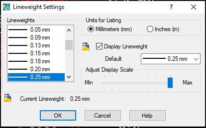

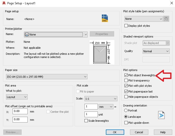

Berzerker Posted August 20, 2020 Author Share Posted August 20, 2020 Got another question about line weight when plotting. I have my line weight on and have set the adjustment to max. When I read more on this subject it tells me I might have to change settings in my plot manager. what do I look for and what do I change to get this to print thicker lines. Quote Link to comment Share on other sites More sharing options...
steven-g Posted August 20, 2020 Share Posted August 20, 2020 Right-click on a layout and select 'plot setup manager' and the 'modify' from there just tick the 'plot lineweight' box and that's it. You also get the same option when you are in the plot dialogue Quote Link to comment Share on other sites More sharing options...
Berzerker Posted August 20, 2020 Author Share Posted August 20, 2020 Mine was a little different but I found it. Thanks steven-g Quote Link to comment Share on other sites More sharing options...
