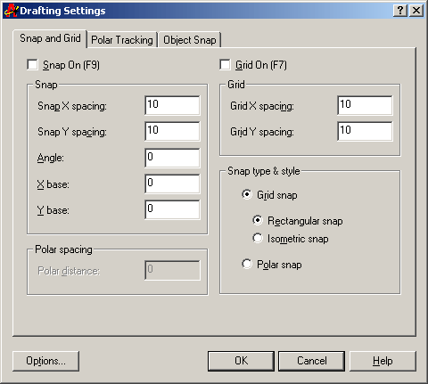

The Snap and Grid mode settings, can also be made from the Drafting Settings dialogue box, illustrated below .This dialogue can be invoked from the command line or from the pull-down menu but probably the simplest way is to right-click on either the GRID or SNAP buttons on the status bar and choose "Properties…" from the context menu. The advantage of the Drafting Settings dialogue box is that it gives you one-stop access to all the Grid and Snap settings.
These options act in the same way as those in the respective commands described above, see The Snap Command and The Grid Command for details. If you are creating drawings in isometric projection, use the "Isometric snap" option to change the grids from the standard orthogonal square grid to a 30 degree isometric grid.

Start AutoCAD and use the "Start from Scratch" option from the "Start Up" dialogue box. If you are already using AutoCAD, create a new drawing by clicking on the
button and use "Start form Scratch" from the "Create New Drawing" dialogue box.
Display the Drafting Settings dialogue box by selecting Drafting "Settings..." from the "Tools" pull-down menu. Click on the "Snap and Grid" tab. In the Snap type & style section of the dialogue, set the type to "Grid snap" and the style to "Isometric snap", as shown in the illustration. Now, check the two boxes at the top of the dialogue, once for "Snap On" and once for "Grid On". Click on the "OK" button to confirm these mode changes. The graphic window now displays a grid of dots arranged at an angle of 30 degrees and the crosshairs will jump from one dot to another. Notice also, that the crosshairs are oriented in the left hand isoplane.
