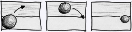

Story Board
Once you have decided that animation is the way to go, there are a number of processes you must go through in order to complete the project. Broadly speaking there are 7 processes involved. Only 3 of which are covered in detail in this tutorial. The 7 processes are:
Inspiration and Visualization
The initial idea for the animation and picturing it in your minds eye.
Storyboarding
Creating a sort of comic strip description of what will happen during the animation. This is a good way to get your initial ideas down on paper and can be used as a reference during the animation process. The simple 3 image storyboard shown above describes the animation we are about to create.

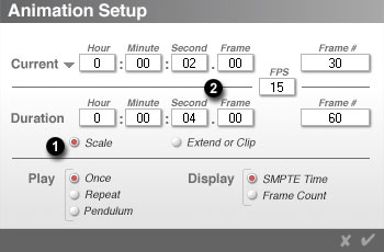

1 Animation Setup
Animation Setup Dialogue Box This involves setting values for the number of frames per second and the duration of the animation. Select FileAnimation Setup… from the pull-down menu. If you don't see a pull-down menu, move your cursor to the top of the screen and hover until the menu appears. You will now see the Animation Setup dialogue box shown above. There are two settings that we must make before we start moving things about.
The first setting is displayed in a box labelled FPS. This stands for Frames Per Second. Bryce needs to know how many frames will be used to describe each second of animation. The default value is 15. So, what value should be used? The frame rate you choose will depend upon how the animation will be viewed. For example, if you are creating a hight quality animation that will be played on video tape, you will want to use an FPS value of 30. Video tapes play at 30 frames per second. However, if you want to view the animation on a computer, you can get away with a much lower frame rate. A value of 15 will give a good smooth animation on a computer. Bear in mind that the higher the frame rate, the larger the resulting animation file will be. Since animation files can be very big, you might even want to drop the frame rate lower than 15 if file size is a problem. You can probably go as low as 10 frames per second before the quality of the animation becomes unacceptable. In most cases, though and in this case in particular, the default value of 15 frames per second will be just fine, so that's what we'll use.
The second setting we need to make is the duration of the animation. Although this value can easily be changed later, it's a good idea to get it about right from the start. You need to think about all the changes that will take place in your animation and work out how long it should all take. One good way of doing this is to use a stopwatch to record the time as you run through the animation in your head. In this particular case, we are creating a very simple animation and so our duration is going to be set to just 2 seconds. Notice that by default, animation times are expressed in Hours, Minutes, Seconds and Frames. This scheme is called SMPTE (pronounced "simptee"). A time of 2 seconds in SMPTE time is expressed as "00:00:02.00".
Set values for Frames Per Second and Duration in the Animation Setup dialogue box as indicated. When you have done this, the Frame# box should display a value of 30. This is the total number of frames in the animation. 15 frames per second for 2 seconds equals a total of 30 frames. Now click the to complete step 1.

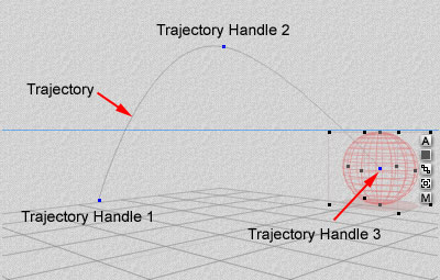

Trajectory
Now that all three keyframes have been set, you should see three trajectory handles. Each one indicates the position of the centre of the sphere when the keyframe was set. You should also see the curved trajectory passing through each of the handles.

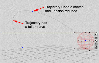

10 Modifying the Trajectory and Time
At this point in the process, you may be thinking, "the sphere is moving at the wrong speed", it might be too fast or too slow. Or, you may be thinking, "the trajectory isn't quite right". These are both very common situations. It is unusual to get a keyframe animation right first time.
OK, we want to tweak the trajectory so that the movement of the sphere is slightly different. How can this be done? Well, actually it's really easy. If you move your cursor over one of the Trajectory Handles, you will see it turn into a 4 headed arrow. Simply click and drag to move the position of the handle. The trajectory will change as the handle is moved. The "Tension" of the curve can also be modified. If you hold down the "T" key on the keyboard as you hover the cursor over a Trajectory Handle, the cursor will turn into a 2 headed arrow. If you click and drag now, you can modify the curve so that it becomes either sharper or fuller depending upon which direction you drag. Drag right for a sharper curve and left for fuller curve. You may also modify the "Continuity" and the "Bias" of the trajectory by holding down the "C" and "B" keys respectively. Continuity is used to control whether a curve is continuous or broken. A broken curve might have a curved segment to the left of a Trajectory Handle followed by a segment with a fuller or flatter curve to the right. Using this method, it is possible to make dramatic changes in direction at Trajectory Handle points rather than smooth transitions. The Bias controls the emphasis of the curve to either one side or the other of the Trajectory Handle. As is usual in such cases, you can best understand how these things work by experimenting with them.
Trajectory Modified
In the illustration above, the trajectory has been modified by moving the second Trajectory Handle and then changing the Tension of the curve to increase the radius, giving a fuller curve.

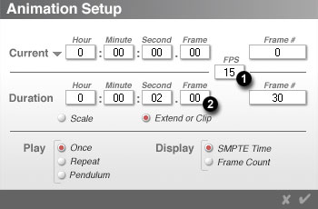

Animation Setup Dialogue Box So, what if we now want to change the speed of the sphere? Well, time in Bryce can be scaled. You can do this using the Animation Setup dialogue box. From the pull-down menu, select FileAnimation Setup…. If you look at the Duration section of the dialogue box, you will see two radio buttons, one labelled "Scale" and the other "Extend or Clip". Say we wanted our animation to last 4 seconds; we have two options. If we set the Duration to 4 seconds and choose to Extend or Clip (the default), our 2 second keyframed animation will be unaffected but we will gain an extra 2 seconds on the timeline. This is useful if we want more time to continue our animation of the sphere. However, if we choose the Scale option, our keyframed animation will be stretched out over 4 seconds. The keyframe we previously set at 1 second will now appear at 2 seconds on the timeline and our 2 second keyframe will appear at 4 seconds. Effectively, we will have doubled the length of the animation. The result is that the sphere moves along the same trajectory but takes twice as long to do it. In other words, the sphere will move at half the speed it did previously. Using the same logic, we can also speed up the sphere by reducing the time. If we choose the Scale option and set the Duration to just 1 second, the sphere will travel at twice the original speed.

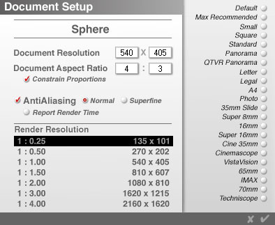

11 Specify Render Output Frame Size
Before rendering the animation, we must decide on the size of the animation frame. The size is important because it dramatically affects the finished movie file size.Document Setup Dialogue Box Also, we must consider how the movie will be viewed and how complex the scene is. More complex scenes will need a larger frame size. You will only really be able to make these kind of decisions with some experience but my general rule of thumb is that it doesn't need to be as big as you think it does. For example, the animation right at the top of this page is just 135 pixels wide and 101 pixels high. Obviously it's a very simple scene, but it is perfectly clear and the file size is relatively small.
To set the render frame size, select FileDocument Setup… from the pull-down menu. You will see the Document Setup dialogue box shown above. Bryce refers to the render frame size as "Render Resolution", which is a little misleading but don't let that confuse you. All dimensions are expressed in pixels as you might expect but the available sizes are all in multiples of the "Document Resolution", that's the working area to you and me. This is actually quite logical. Simply select an output size from the list under Render Resolution and click to save the new settings. If you want a particular output size, you'll need to change the Document Resolution first and then the Render Resolution.
