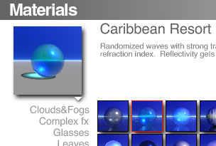

Go to the Materials Library. Either, click on the Edit Material icon
and then click the small arrow at the top right of the preview area in the Materials Lab or take the short-cut, click on the small arrow to the right of the word "Edit" on the toolbar.
When you arrive at the Materials Library, click on "Waters & Liquids" in the list of material types. You will find the Caribbean Resort material second along in the top row. Click the material icon to select it and then click
to apply the material to Water_1.

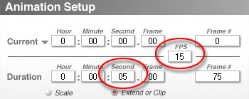

You now need to decide how long your animation is going to be and how many frames per second (FPS) will be used. Go to the Animation Setup dialogue box, from the pull-down menu. Enter values for the Duration and FPS as required. If you are not sure about this, see the Animation Setup section of the Keyframe Animation tutorial for details.
For the purposes of this exercise, we'll use a Duration of 5 seconds and a FPS rate of 15. Enter these values and click
to apply them.

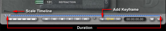

You may now want to scale the Timeline so that you can see the whole duration at the bottom of the screen. This makes working with keyframes a little easier. See Scale the Timeline for details.

to go to the Materials Lab. You should see that the Materials Lab has its own timeline. This is scaled independently from the main timeline. Scale this timeline so that you can see the whole duration of the animation.
