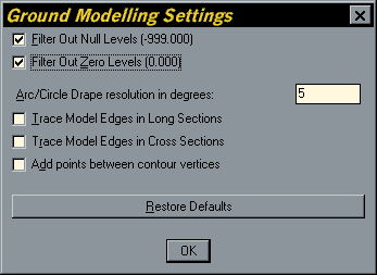

Arc/Circle drape resolution is 5.00 degrees - use KTFC to change.
The Arc/Circle drape resolution is the angular interval between the 3D Polyline vertices when Arcs and Circles are converted to 3D Polylines. The default value (5.00) gives a good rendition of curved objects under most circumstances. However, if you need to either increase or decrease this value, you can do so using the KTFC (Key TERRA-FIRMA Configuration) command and changing the value in the "Ground Modelling Settings" dialogue box. TERRA-FIRMA then continues:

  • It often occurs that some of your contours may have a zero elevation because they have been omitted from the elevating process. These contours are often difficult to spot, however, by setting the "XY Plane" angle to zero in the AutoCAD DDVPOINT command you should see any zero contours at the bottom of the screen.
  • Ground Modelling Settings Dialogue BoxYou can force TERRA-FIRMA to ignore any zero elevations using the KTFC command. Type KTFC at the keyboard and then click on the Ground "Modelling..." button in the "KT-F Configuration" dialogue box. In the "Ground Modelling Settings" dialogue box, check the "Filter Out Zero Levels" option. Click the "OK" button and then the "Done" button. Ground model creation will now ignore all zero elevation data.
