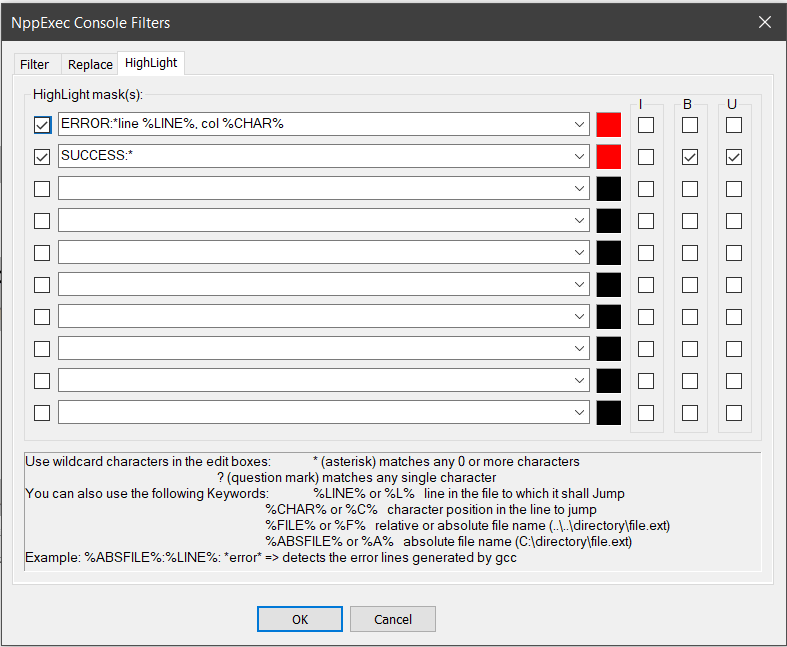

@BIGAL, I am quite sure you settled your issue in N++ a long time ago. I was facing the same situation so maybe the following will be of interest to you. I am using NppExec to Validate and Load a file to Autocad. The NPPexec either save either a Selection or the Whole active window of Notepad++ in a tempfile called "D:\Lisp\NppVal.lsp". This has to be a trusted Autocad Location. NppExec then transfer execution to a PowerShell script called ValidateAndLoad.ps1. This script is placed in directory "C:\Scripts\ValidateAndLoad.ps1" . The powershell validates the lisp and then if valid, Load it in Autocad. It then Activate the Autocad Window and brings it into view. All that need to be done is to start the command you just loaded. To Activate and bring in View, all the usual command were failing until I found a little utility called nircmd. So that is what the ps1 script uses. You will need to downlad it from https://www.nirsoft.net/utils/nircmd.html and place it in same directory "C:\Scripts" as the ps1 script. Following is the NppExec script: npp_console 1 env_set NPP_FILENAME = $(FILE_NAME) // Get selection info sci_sendmsg SCI_GETSELECTIONSTART set local pos_start = $(MSG_RESULT) sci_sendmsg SCI_GETSELECTIONEND set local pos_end = $(MSG_RESULT) sci_sendmsg SCI_LINEFROMPOSITION $(pos_start) set local start_line = $(MSG_RESULT) // Create temp file for current context if $(pos_start) == $(pos_end) then // No selection: Save whole file sci_sendmsg SCI_SELECTALL sel_saveto "D:\lisp\NppVal.lsp" sci_sendmsg SCI_SETEMPTYSELECTION $(pos_start) cmd /c powershell -NoProfile -ExecutionPolicy Bypass -File "C:\Scripts\ValidateAndLoad.ps1" -FilePath "D:\lisp\NppVal.lsp" -ScintillaLine 0 -IsSelection 0 else // Selection exists sel_saveto "D:\lisp\NppVal.lsp" cmd /c powershell -NoProfile -ExecutionPolicy Bypass -File "C:\Scripts\ValidateAndLoad.ps1" -FilePath "D:\lisp\NppVal.lsp" -ScintillaLine $(start_line) -IsSelection 1 endif env_unset NPP_FILENAME Note: NPP script does not save your file by design, when debugging I don't want to Save. Following is the ValidateAndLoad.ps1 param( [string]$FilePath, [int]$ScintillaLine = 0, [int]$IsSelection = 0 ) $ErrorActionPreference = 'Stop' $TargetDir = 'D:\lisp' $TargetFile = Join-Path $TargetDir 'NppVal.lsp' $NirCmdPath = 'C:\scripts\nircmd.exe' $MaxRetries = 10 $RetryDelayMs = 300 if (-not $FilePath) { Write-Output "ERROR: No file path provided." exit 1 } if (-not (Test-Path -LiteralPath $FilePath)) { Write-Output "ERROR: File not found: $FilePath" exit 1 } try { $enc = [System.Text.Encoding]::GetEncoding(1252) $Text = [System.IO.File]::ReadAllText($FilePath, $enc) } catch { Write-Output "ERROR: Failed to read file: $($_.Exception.Message)" exit 1 } $FileName = [System.Environment]::GetEnvironmentVariable("NPP_FILENAME") if (-not $FileName) { $FileName = "Unsaved Document" } Write-Output "VALIDATING: $FileName" $level = 0 $inString = $false $inComment = $false $inBlockComment = $false if ($IsSelection -eq 1) { $line = $ScintillaLine + 1 } else { $line = 1 } $col = 0 $bracketStack = [System.Collections.Generic.List[PSCustomObject]]::new() $expressionStack = @() $global:defunCount = 0 function New-ValidateExpression { param( [string]$ExprText, [int]$StartLine, [int]$StartCol, [boolean]$IsQuoted ) $cleanText = $ExprText -replace "\([^\(\)]*\)", " #EXPR " $cleanText = $cleanText.Replace("`r", " ").Replace("`n", " ").Trim() $tokens = $cleanText -split '\s+' | Where-Object { $_ -ne "" } if ($tokens.Count -eq 0) { return } $firstToken = ([string]$tokens).ToLower() if (-not $IsQuoted) { if ($firstToken -like '"*') { Write-Output "ERROR: First element in expression cannot be a string literal at line $StartLine, col $StartCol" exit 1 } if ($firstToken -match '^[+-]?[0-9]+(\.[0-9]+)?$') { Write-Output "ERROR: First element in expression cannot be a numeric literal at line $StartLine, col $StartCol" exit 1 } } if ($firstToken -eq "setq") { $argCount = $tokens.Count - 1 if ($argCount -eq 0) { Write-Output "ERROR: 'setq' requires at least one symbol-value pair at line $StartLine, col $StartCol" exit 1 } if ($argCount % 2 -ne 0) { Write-Output "ERROR: 'setq' has an odd number of arguments ($argCount) at line $StartLine, col $StartCol" exit 1 } } } for ($i = 0; $i -lt $Text.Length; $i++) { $c = $Text[$i] $col++ if ($c -eq "`n") { $line++ $col = 0 } if (-not $inString) { if ($inBlockComment) { if ($c -eq '|' -and $i + 1 -lt $Text.Length -and $Text[$i+1] -eq ';') { $inBlockComment = $false $i++ $col++ } continue } if ($inComment) { if ($c -eq "`n") { $inComment = $false } continue } if ($c -eq ';' -and $i + 1 -lt $Text.Length -and $Text[$i+1] -eq '|') { $inBlockComment = $true $i++ $col++ continue } if ($c -eq ';') { $inComment = $true continue } } if ($c -eq '"') { $isEscaped = $false if ($i -gt 0 -and $Text[$i-1] -eq '\') { $slashCount = 0 $k = $i - 1 while ($k -ge 0 -and $Text[$k] -eq '\') { $slashCount++ $k-- } if ($slashCount % 2 -ne 0) { $isEscaped = $true } } if ($isEscaped) { if ($expressionStack.Count -gt 0) { $expressionStack[-1] += $c } continue } $inString = -not $inString if ($expressionStack.Count -gt 0) { $expressionStack[-1] += $c } continue } if ($inString) { if ($expressionStack.Count -gt 0) { $expressionStack[-1] += $c } continue } if ($c -eq '(') { $level++ $isListQuoted = $false if ($i -gt 0 -and $Text[$i-1] -eq "'") { $isListQuoted = $true } elseif ($bracketStack.Count -gt 0) { $isListQuoted = $bracketStack[-1].IsQuoted } $bracketStack.Add([PSCustomObject]@{ Line = $line Col = $col IsQuoted = $isListQuoted }) $expressionStack += "" if (-not $isListQuoted -and $i + 10 -lt $Text.Length) { $lookAheadSlice = $Text.Substring($i + 1, 10).ToLower() if ($lookAheadSlice -match '^\s*defun(-q)?(\s|$)') { $global:defunCount++ } } if ($i + 1 -lt $Text.Length -and $Text[$i+1] -eq ')') { $isDefunArgs = $false if ($expressionStack.Count -gt 1) { $parentExpr = $expressionStack[-2].Trim().ToLower() if ($parentExpr -like "defun*" -or $parentExpr -match "(^|\s)defun(-q)?(\s|$)") { $isDefunArgs = $true } } $isQuotedList = $isListQuoted if ($i -gt 1 -and $Text[$i-1] -match '\s' -and $Text[$i-2] -eq "'") { $isQuotedList = $true } if (-not $isDefunArgs -and -not $isQuotedList) { Write-Output "ERROR: Empty parentheses () found outside of a function definition at line $line, col $col" exit 1 } } continue } if ($c -eq ')') { $level-- if ($level -lt 0) { Write-Output "ERROR: Unexpected closing parenthesis ')' at line $line, col $col" exit 1 } if ($bracketStack.Count -gt 0) { $finishedExpr = $expressionStack[-1] $lastIndex = $bracketStack.Count - 1 $currentBracket = $bracketStack[$lastIndex] $bLine = $currentBracket.Line $bCol = $currentBracket.Col $bQuoted = $currentBracket.IsQuoted New-ValidateExpression -ExprText $finishedExpr -StartLine $bLine -StartCol $bCol -IsQuoted $bQuoted $bracketStack.RemoveAt($lastIndex) if ($expressionStack.Count -gt 1) { $expressionStack = $expressionStack[0..($expressionStack.Count - 2)] $expressionStack[-1] += " #EXPR " } else { $expressionStack = @() } } continue } if ($expressionStack.Count -gt 0) { $expressionStack[-1] += $c } } if ($level -gt 0) { $lastOpen = $bracketStack[-1] Write-Output "ERROR: Unclosed parenthesis '(' starting at line $($lastOpen.Line), col $($lastOpen.Col)" exit 1 } Write-Output "SUCCESS: Validated $global:defunCount function(s) successfully." if (-not (Test-Path -LiteralPath $TargetDir)) { New-Item -ItemType Directory -Path $TargetDir -Force | Out-Null } try { $enc = [System.Text.Encoding]::GetEncoding(1252) [System.IO.File]::WriteAllText($TargetFile, $Text, $enc) } catch { Write-Output "ERROR: Failed to write $TargetFile : $($_.Exception.Message)" exit 2 } if (Test-Path -LiteralPath $NirCmdPath) { try { Start-Process -FilePath $NirCmdPath -ArgumentList 'win activate stitle AutoCAD' -WindowStyle Hidden | Out-Null Start-Sleep -Milliseconds 500 } catch { } } $acad = $null for ($i = 1; $i -le $MaxRetries; $i++) { try { $acad = [Runtime.InteropServices.Marshal]::GetActiveObject('AutoCAD.Application') if ($acad) { break } } catch { Start-Sleep -Milliseconds $RetryDelayMs } } if (-not $acad) { Write-Output "ERROR: Could not attach to a running AutoCAD instance." exit 4 } try { $safePath = $TargetFile.Replace('\', '\\') $acad.ActiveDocument.SendCommand("(load `"$safePath`")`n") Write-Output "SUCCESS: Loaded $TargetFile" exit 0 } catch { Write-Output "ERROR: Failed to send load command to AutoCAD: $($_.Exception.Message)" exit 5 } Notes: Autocad has to running and a drawing open in order to load. If validation fails you are dumprd back to N++ with the NppExec console showing you where it fails. If you double click on the error line you cursor in N++ will go to that line. Bear in mind that the error location is not perfect, but you are normally in the right function. Finally to get the error lines and Success lines to appear in red, you have to set the NppExec Console Filters as shown in the below image. Phew!! that was a long post. ymg
