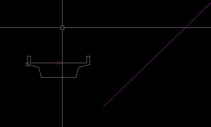

  2. Hi I am having a problem with the SWEEP command. I have defined a 2d polyline profile which i want to sweep along a 3D polyline alignment. If I use a basepoint in the middle of the profile (red circle) the function fails, if however I use another point (green square) the command works. See attached .DWG. Bridge Model.dwg What am i doing wrong?

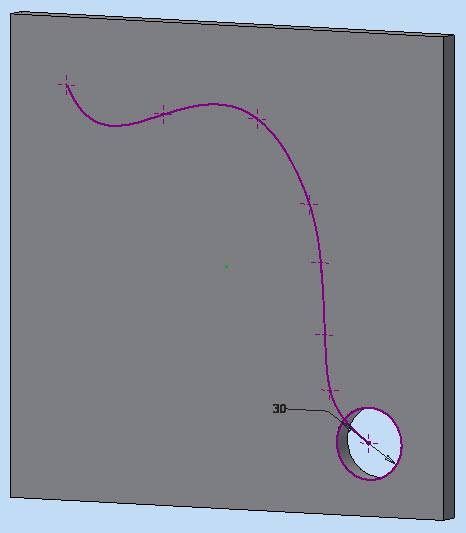

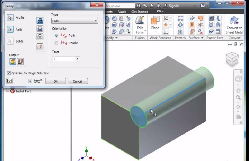

  3. I tried slotting a plate along an irregular line by SWEEPing an extruded hole alone a spline No luck! Inventor 2015 does not select the spline as a path. I must have this wrong somehow but I cannot find any tutorial material that covers it. Can someone please tell me the right way. Thanks Page 15 Cam Plate.ipt

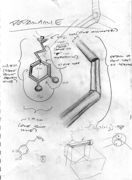

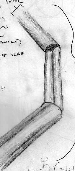

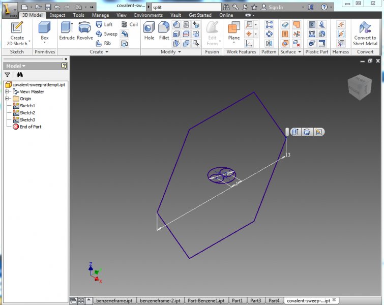

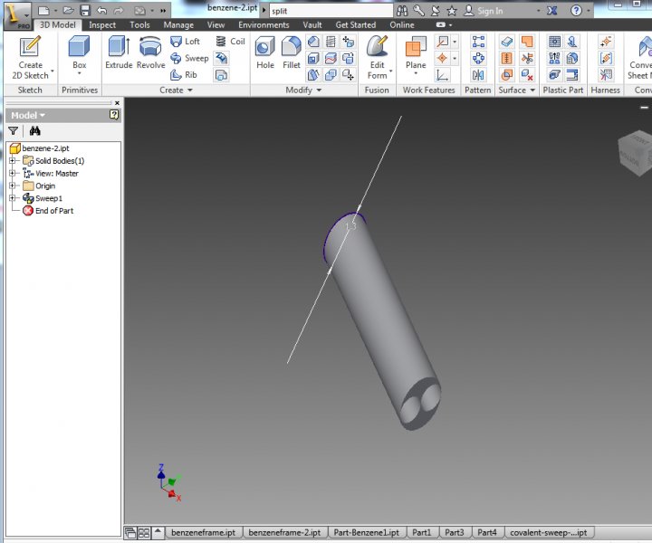

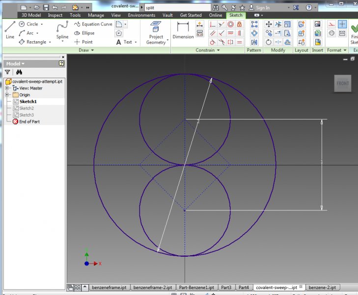

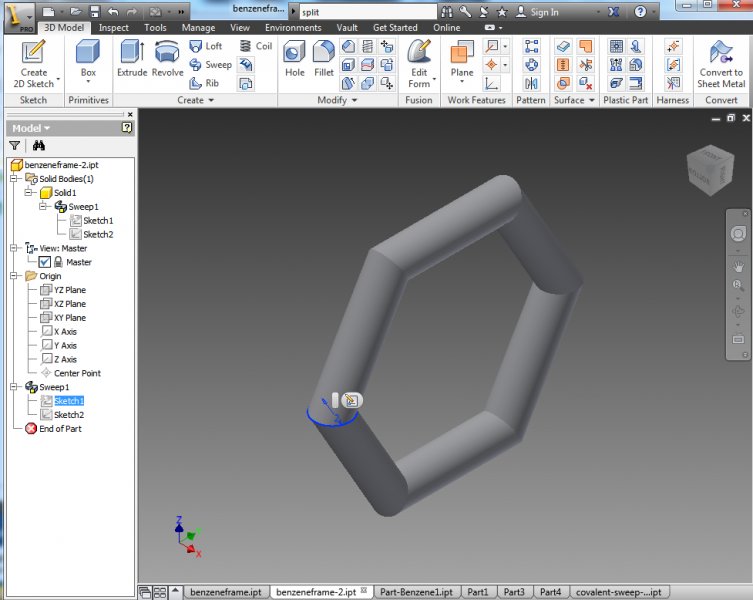

  6. I am trying to make a stylized model of a molecule and having some issues. Here's the sketch of what I'm trying to create: So far, I've been able to sweep a circle around a hexagon-shaped path, which will create the single-bonds in the benzene ring in the finished product: I made a circle on the XY plane, then made a hexagon-shaped path on the YZ plane, did a coincident contraint on the center of the circle and attached it to the path and then did a sweep along the hexagon path. Hooray. Then I needed to create the covalent / double-bars on every other section. I figured I would create another hexagon-swept ring, but with all double-bars, and then cut and copy the bits of each together afterwards so it would look like this: I tried sweeping to faces, but it only gave me one segment, but it didn't work. So then I thought I'd sweep two circles around the edges of a square-faced sweep in hexagon form to end up with two rows, like in this example: So here's my attempt, but I can't get the edge of the square in the middle of the two guide circles to coincident-constrain to the corner point of the hexagon path (I tried "project geometry" to no avail, and it's turned on automatically): Here's the sketch of the face I'm trying to sweep: Not sure why it's not working this time around, and I might be going about this the wrong way... would love some help on this. Thanks!

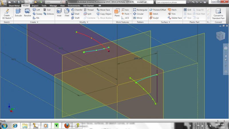

  11. Hey, I'm pretty new to Autocad and I'm trying to draw one of those new energy-saving lightbulbs in 3D. It's a Phillips Mini Decorative Twister bulb to be exact. I'm trying to make it as accurate as possible. I have the base done and I did the spiral/middle part of the bulb, but I ran into a problem when I tried to do the bottom of the bulb where it meets the base. I used a spline since the bottom part of the bulb meets the spiral part at an odd angle, then curves at almost 90 degrees and goes straight to meet with the base. The problem is when I tried to sweep a circle along the spline Autocad wouldn't let me. If someone can help me with this or give me some tips on how best to do the bottom and top parts of the bulb, it would be much appreciated. Thanks.
