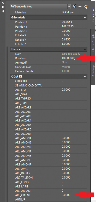

Hello, As part of a project I must assign an object data table to all elements of the drawing according to their layer. I am looking for an automated solution to assign the Objects Data tables to the elements of the drawing other than by selecting the different layers one by one. Knowing nothing in programming, I ask you to find ways to achieve this result. On the other hand, once the object data tables (Object data) assigned to the various elements I want to find a way fast enough to copy some attribute objects in the corresponding "Object Data" fields. For example copy the value of the orientation of a block (Attribute Value "Rotation") in the corresponding OD field (Attribute Value "ARE_ORIENT"), as in the attachment. I am currently doing these manipulations by hand and this is a huge waste of time. I am interested in any solution as small as it is! Thank you!!

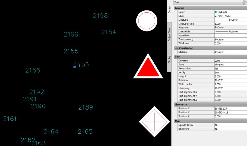

Insert Block on multiple text object insertion points.
asb116 posted a topic in AutoLISP, Visual LISP & DCL
So heres the deal.... I work for a big company and we have this multi-million dollar project I'm currently working with. My situation is that I have survey data imported into my drawing, these points come in as text objects with their insertion point being the co-ordinates of the respective point, this is done using a custom command. I also have a directory of blocks that are used to represent various different survey related symbols. Right now the process I must go through to get the symbols onto their proper point is to manually search out each point and inset the block ref manually onto the point. Doing this for thousands of points will be far too time consuming. Im trying to find a LISP routine that will allow me to pick which block I wish to insert, then allow me to specify the numerical point range or individual points to insert that block on. Attached is a screencap of the text points and the blocks shown beside them. Essentially I have a whole lot of points and a whole lot of symbols to put on them, but different points and point ranges need different symbols. Any insight would be great, I'd attempt to write a routine myself, but time constraints prevent me from working on it with th deadlines we have in place. -
