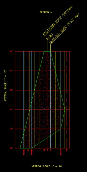

ReMark Posted September 26, 2012 Share Posted September 26, 2012 Section A Section B Disclaimer: I did not draw these sections and if I did I might have done it differently. Quote Link to comment Share on other sites More sharing options...
gowinmodi Posted September 26, 2012 Share Posted September 26, 2012 Remark, Thank you very much for send me Images. Driveway profile looks same is my plate-3 but when check in detail dimension is different than me. Tomorrow i will finish and send you Image. Thank you lots do all this for us. Quote Link to comment Share on other sites More sharing options...

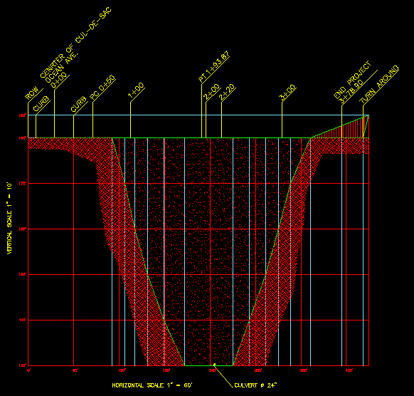

gowinmodi Posted September 27, 2012 Share Posted September 27, 2012 Remark, Here I am sending my Final Image of Driveway profile. please can you check it . Thank you Quote Link to comment Share on other sites More sharing options...

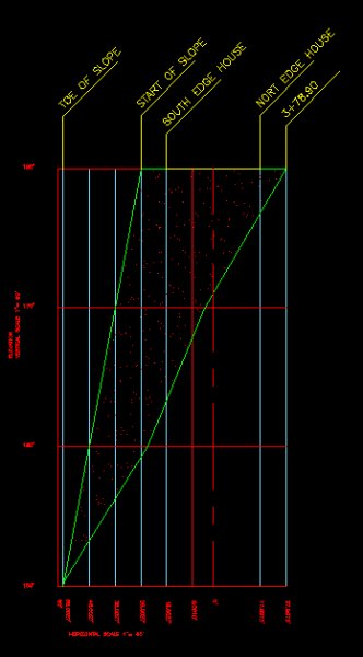

gowinmodi Posted September 27, 2012 Share Posted September 27, 2012 please can you check this section-B line is correct ? Quote Link to comment Share on other sites More sharing options...
ReMark Posted September 27, 2012 Share Posted September 27, 2012 From what I can see it looks like the elevations on the left are too close to the side of the grid and I'm not so sure you have the pipe culvert drawn correctly. Quote Link to comment Share on other sites More sharing options...
gowinmodi Posted September 27, 2012 Share Posted September 27, 2012 Remark, culvert pipe is not actully size because in project book on page 21 " you can make the culvert larger than it actully is. This way, it`s easier to see on this drawing. Indicate the culvert`s true diameter next to the ellipse." Thank you Quote Link to comment Share on other sites More sharing options...
ReMark Posted September 27, 2012 Share Posted September 27, 2012 The ellipse should be taller than it is wide. Quote Link to comment Share on other sites More sharing options...
gowinmodi Posted September 27, 2012 Share Posted September 27, 2012 Remark, Thank you for correction, i will change it. Any other correction ? Thank you Quote Link to comment Share on other sites More sharing options...
ReMark Posted September 27, 2012 Share Posted September 27, 2012 Without having access to the actual DWG it is difficult to say. Quote Link to comment Share on other sites More sharing options...
