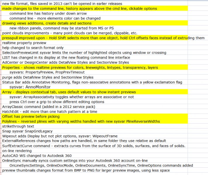

paisis123 Posted January 7, 2013 Share Posted January 7, 2013 What is the main differences in AutoCAD 2012 vs. 2013? I looked at the website and it didnt really give a chart or explain much ALL the differences or changes. Mods, please move this thread as you see fit. Thanks! Quote Link to comment Share on other sites More sharing options...
rkent Posted January 7, 2013 Share Posted January 7, 2013 Here are the main points. The yellow highlighting is mine to indicate the most important changes for me. Quote Link to comment Share on other sites More sharing options...
paisis123 Posted January 7, 2013 Author Share Posted January 7, 2013 Wow. I thought the changes were minor, But this makes me want to upgrade literally immediately. I heard that you can scan pictures or drawings right into AutoCad 2013? If thats the case then it make my job so much better then making drawings from lame PDFs. Quote Link to comment Share on other sites More sharing options...
JD Mather Posted January 7, 2013 Share Posted January 7, 2013 top 3 from rkent's list for me are command line click option associative array improvements drawing view creation (from 3D model) improvements Quote Link to comment Share on other sites More sharing options...
