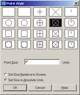

A When subdividing linework, AutoCAD doesn't snip it into bits, it places a point object at the requested intervals. Points can then be snapped to using the Node object snap. To set the point display mode (PDMODE), choose Format/Point Style to open the Point Style dialog box. After making your selection from the group of icons, I would recommend setting the size to the Absolute Units setting then enter the Point size as necessary. For drawings smaller than a breadbox, a size of 0.5 may be a good starting point (pun intended). For larger drawings of the architectural variety, start with 4 and see how it looks.
