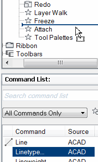

  1. Open the CUI.
  2. In the Command list, drag the Linetype… command up into the list of your QAT content.

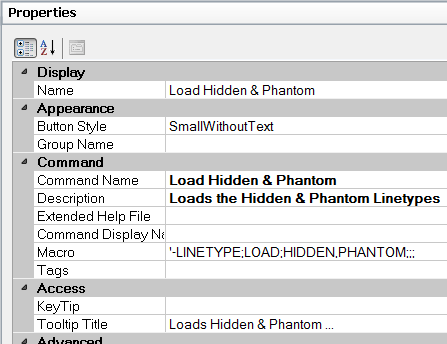

  3. Click on the Linetype… command in the QAT, and the Properties for the command are displayed on the right side of the CUI.
  4. For the Macro, enter the following:
    '-LINETYPE;LOAD;HIDDEN,PHANTOM;;;
    Note: Notice there's a comma between the names of the linetypes being loaded.
  5. Now modify the other Properties to something like you see in the image shown.

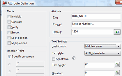

For those of you unfamiliar with creating an Attribute Definition, here are the steps I used to create the attribute I used for that Dynamic Block.
How to Create an Attribute Definition
  1. Set the desired layer and text style to be current.
  2. On the Insert tabBlock Definition panel, click Define Attributes to open the Attribute Definition dialog box.
  3. Fill in the Tag, Prompt, and Default fields similar to that shown in this illustration, and set the Justification to Middle Center.
    I would recommend you check the box to Specify On-Screen, and the text height should be appropriate for the application.
  4. Click OK after configuring your attribute definition, then place the resulting definition in the drawing.

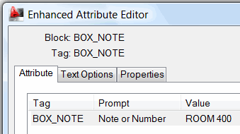

Enhanced Attribute EditorAt this point, you can continue on with the steps to create the Dynamic Block that stretches found in August 2011.
Once you place that block, you can single-click on it to adjust the width and/or double-click it to open the Enhanced Attribute Editor where you can change the text!

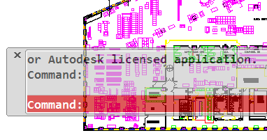

Float the command lineNot sure why you'd do this, but then, that's why I call it the Odd Spot… and sometimes I find things that are ‘odder’ than others. In this case, adjusting the Transparency setting of the Command line if you float it in the drawing.
How to Set the Transparency of a Floating Command Line
  1. On the left edge of the Command line, click on the vertical bar, then drag it into the drawing area. This will result in a floating Command Line window.
  2. Right-click anywhere in the Command line, then click Transparency to open the Transparency dialog box (which can also be used for tool palettes and – curiously – the Properties palette).
  3. Adjust the upper slider for the transparency of the palette, then click OK to close and apply your setting. In this figure, I set the transparency to 60% Opacity.
  4. Now position the Command line over some objects in the drawing and you'll see through the Command line!
Transparent command line
Note: When you approach the Command line with your cursor it becomes more opaque, and when you click in Command line, it becomes completely solid. I welcome any ideas on a practical application for this feature, (unless you figure they did it just because they could!)

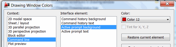

AutoCAD 2012 enables you to set the color of not only the Command line. More specifically, the color of the Active Prompt Background (and Text) can be set independent of the color for the Command History Background.
Drawing Window Colors
How to Set your Command Line Color
  1. Right-click in the Command line, then click Options.
  2. On the Display tab, click Color to open the Drawing Window Colors dialog box shown here.
  3. Under Context, Click Command line, then under Interface Element, click the desired element of the Command line.
  4. Now choose a Color for the selected element. If you gom it up, you can always click Restore Current Element, otherwise, click Apply & Close to see your colors.
