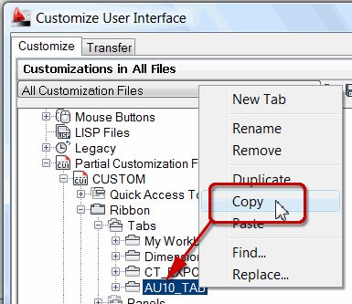

  1. Type CUI to open the Customize User Interface.
  2. Navigate to the location of your customized tab. I typically encourage folks to put their customization files under Partial Customization FilesCUSTOMRibbonTabs.
  3. Copy new tab
    Right-click on your customized Tab, then click Copy
    Note: When you copy a tab, any panels that are associated with that tab are automatically included in the copied content.

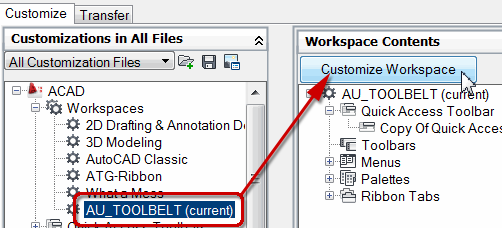

  1. To add your new tab to a workspace, under the Workspaces node, click the name of the Workspace where you want this tab to live.
  2. Customize Workspace
    Under Workspace Contents, click Customize Workspace.
  3. Now, under Partial Customizations FilesCUSTOM, put a check in the box beside your new tab. You will then see your new tab listed in your Workspace Contents.

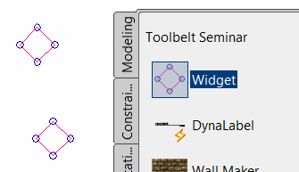

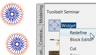

To briefly recap the condition proposed in Michael's Corner, September 2010, you have a block on your palette named Widget, and you have placed several instances of that block in a drawing named ABC. If the Widget block is modified in its Source file (the drawing file from which it was placed onto the palette), what do you do to update the instances of Widget in drawing ABC? My solution was waaaay too complex and Kent's solution is waaaay easier.
Solution: Open the drawing ABC containing multiple instances of Widget, right-click on the Widget block on the palette, then click Redefine. Most excellent!
Before
Before
After
After
Note: When you change the block definition in the block's source file, right-click on the block on the palette and click Redefine Image to display the correct geometry for the edited block.

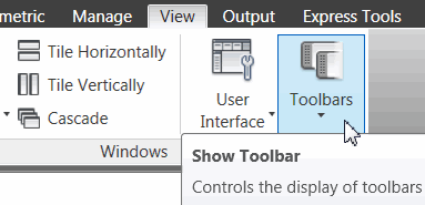

The Ribbon / Toolbar battle has now mellowed with age (albeit all of 3 years). Apart from involvement within the CUI, there was no immediately obvious way to include a toolbar in a Ribbon workspace… until now.
Show Toolbar
On the View tab of the AutoCAD 2011 Ribbon, at the far right end is the Windows panel – a panel that has gone through its fair share of changes – whereon you will find the Toolbars tool which will enable you to turn on your desired toolbars.
