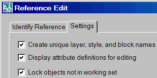

  2. Select the block to which you would like to add the attribute, then right-click and click Edit Block In-Place to open the Reference Edit dialog box.
  3. On the Identify Reference tab, I prefer to use the option Prompt To Select Nested Objects.
  4. On the Settings tab, if you are adding additional attributes, you may want to check the box for Display Attribute Definitions For Editing.
  5. Click OK, then select the nested objects if you are prompted to do so.

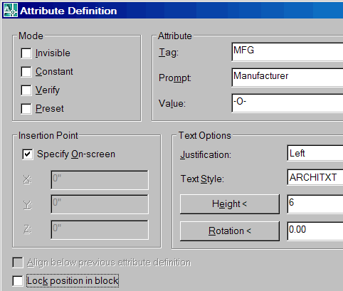

    1. For those of you with existing attributes, you can copy an existing attribute, then double-click the copy and make the desired change for the new attribute.
    2. To make a new attribute, type ATTDEF to open the Attribute Definition dialog box and fill in the appropriate fields for your attribute. In this example, I'm adding a Manufacturer attribute for the chair.
  1. If you are adding a new attribute, click OK to close the dialog box, then place your attribute.

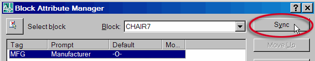

There is a possibility that you will not see the additional attribute, and there is a greater possibility that you won't see the new attribute on the other instances of the block that was edited. Enter Battman (see October 2006).
Instruction to Display the Newly Added Attribute(s)
  1. On the Modify II toolbar, click Block Attribute Manager (or just type BATTMAN) to open the dialog box.
  2. Click Select Block and select the block you added the attribute to.
  3. In the upper right corner, click the Sync button to synchronize all the other instances of the block to reflect the condition of the edited block. Click OK.

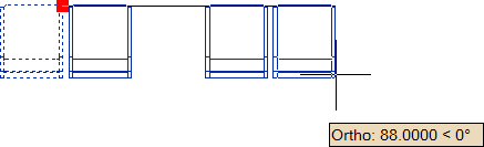

This exercise illustrates how to use grips to array the selected items. I want a row of three pairs of chairs, one chair apart. (By the way, grips are also covered in December 2003 and March 2005.)
Suggested approach:
  1. Turn off Osnap and Otrack as these will display their tool tips and may be confusing the point of the exercise.
  2. Select the item(s) to copy, then click in one of the grips to make it a hot grip.
Hot Grip
  1. Press [Enter] to cycle the auto-edit mode to the Move option, then enter C for the Copy option.
  2. With Ortho on, move the direction for the copy and enter the desired distance. I enter 22 in this exercise.
  3. If you have the current version of AutoCAD, hold down Ctrl, and as you move your cursor in the direction of the copy, AutoCAD "locks" into that spacing! Click to place as necessary. If you have an earlier version of AutoCAD or LT prior to the introduction of Temporary Override Keys, you can hold down the Shift key to lock in the increment.
Copy
NOTE: The increment lock operates in both the X and Y axis!
